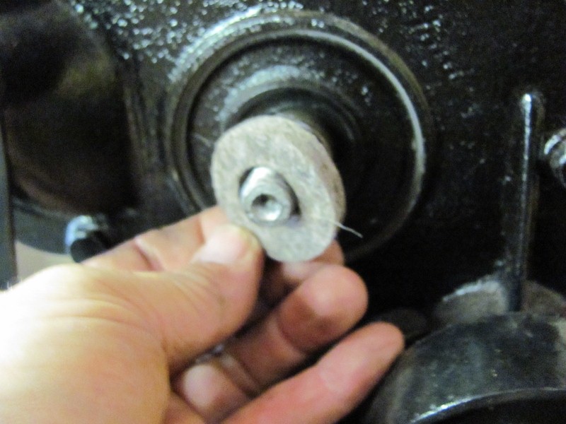

Might try again to check the felt behind the brass shield. If the felt is new it will be too thick and push the shield out, so that keeps the rotor barrel from seating fully. Felt should be rubbed with grease to flatten it some for fit. And others have found reproduction shields aren't exactly to shape with the inner cup for the felt a bit too tall.

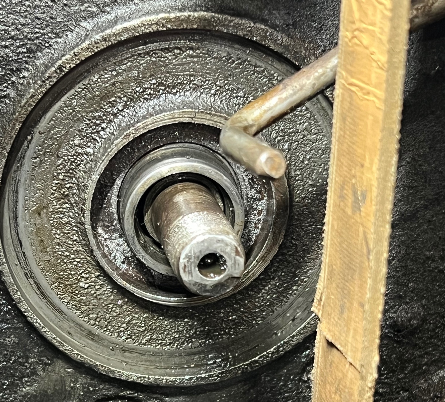

John, I took the radiator off to get a better view of what I was doing. Well, look at the attached photo. There's my issue. Suggestions?

If I’m looking at your latest photo it sure looks like the timing gear cover is off center?
If that’s the issue of your binding roller timer I wonder how your car ran to begin with.
The cam is probably in the correct position in the block itself but the timing gear cover is visibly way off on one side. In other words the timer itself is “off center” but the roller assembly is correct.
I would get another timing gear cover. They are fairly plentiful and inexpensive. Call Lang’s T parts and they probably have a good one. They keep lots of good used T parts. I can’t recall a cover being that far off before. The cam hole is probably correct but the area wher the timer sits is way off to one side.
Thank you, John. The metal sleeve around the cam shaft…is that another part that I’d need? I worry that because it’s so far off that it has ruined something behind the cover

I should also note that the metal sleeve around the cam shaft is also off center itself. The gap around the cam shaft is smaller on the right upper side.

Is the timing gear nut snug, or loose? It would shorten the distance when loose needed for commutator flapper or roller to fit properly on camshaft.

Looking at the end of the camshaft the number of threads showing is a lot less than in the other picture from another poster. This would show a possibility of that cam gear nut being loose and the flange on that nut is probably grinding on the inside of that timing cover with the two camshaft dowel pins retaining position of the gear. After removing the cam cover and retightening that cam gear bolt, you'll need a centering gauge and gaskets along with that neoprene seal . Removing the radiator will give you a lot more room to replace what's needed .

Where can I get a centering gauge? And by gaskets do you mean gaskets for the timing cover? Just asking for clarification and making sure I have everything gathered up!

Go to Lang’s Model T Ford website.
They have the timing cover centering tool and necessary gaskets if you need to remove the cover or loosen the cover bolts and see if it will center up.
You can tell by looking at the cover that when it was made the lips where the timer case sits in aren’t the same width all the way around.
Most if not all the cover pictures you can see on the net or the covers that I have aren’t that far off. The ridges or lips that I call them are the same width all the way around. But that’s my opinion and others may disagree.
Try the centering tool first and you’ll know pretty quick if it doesn’t easily go on. Or if it goes on at all.

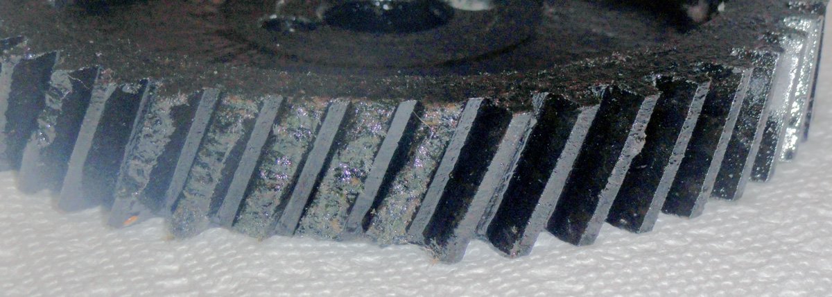

Here's the update on the interesting situation at hand...I removed the camshaft cover. The camshaft lock nut was somehow cross threaded, which caused damage to the cover and two of the threads of the camshaft itself. I'm hoping to thread those, with assistance, of course, to be able to get a new camshaft nut to seat properly. I also discovered that the camshaft gear has been replaced with a composite one. It also appears to be damaged. My plan is to replace that as well. Should I replace it with a metal gear or another composite gear? I'm sure there are a million opinions on that as well but, I eat up suggestions!

This is what happens to both composite gears and nylon gears. If you plan on driving your Model T, then my advice- go with bronze or aluminum. I prefer bronze- some members here say the aluminum ones "ring", but I've never run aluminum, so I can't say.

A Dan Mceachern bronze gear is the best available. Best quality.

Could not get the Roller brush to seat properly on the camshaft. After digging, discovered that the camshaft lock nut had somehow backed off from the camshaft timing gear and became cross threaded. It wore a grove into the timing gear cover and the camshaft timing gear itself.
Solution was to fix threads (thankfully able to file them back to a useful state, replaced camshaft timing gear with a bronze Dan Mceachern gear, replace camshaft lock nut, replace timing cover and reassembled the car. Runs like new.

The "metal sleeve" is part of the camshaft nut. It is what the modern seal runs on. If it is damaged/ pitted, the old felt seal may be the better option.
The cover does look to be installed off-centre. Do not be concerned about the machining in the cover being offset to the casting. This is common. The answer may be in removing the cover and re-installing it with a centering tool to set it up correctly. With the cover off, you could install a new cam nut with a smooth seal surface.
