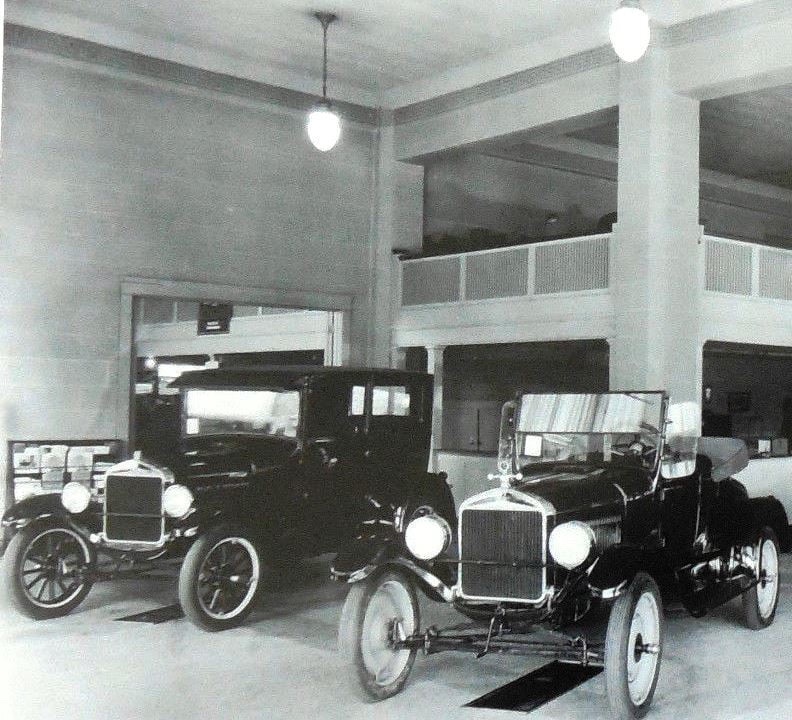

Here’s some new T’s in 1927 doing their thing in a Ford showroom. I guess it was expected.
