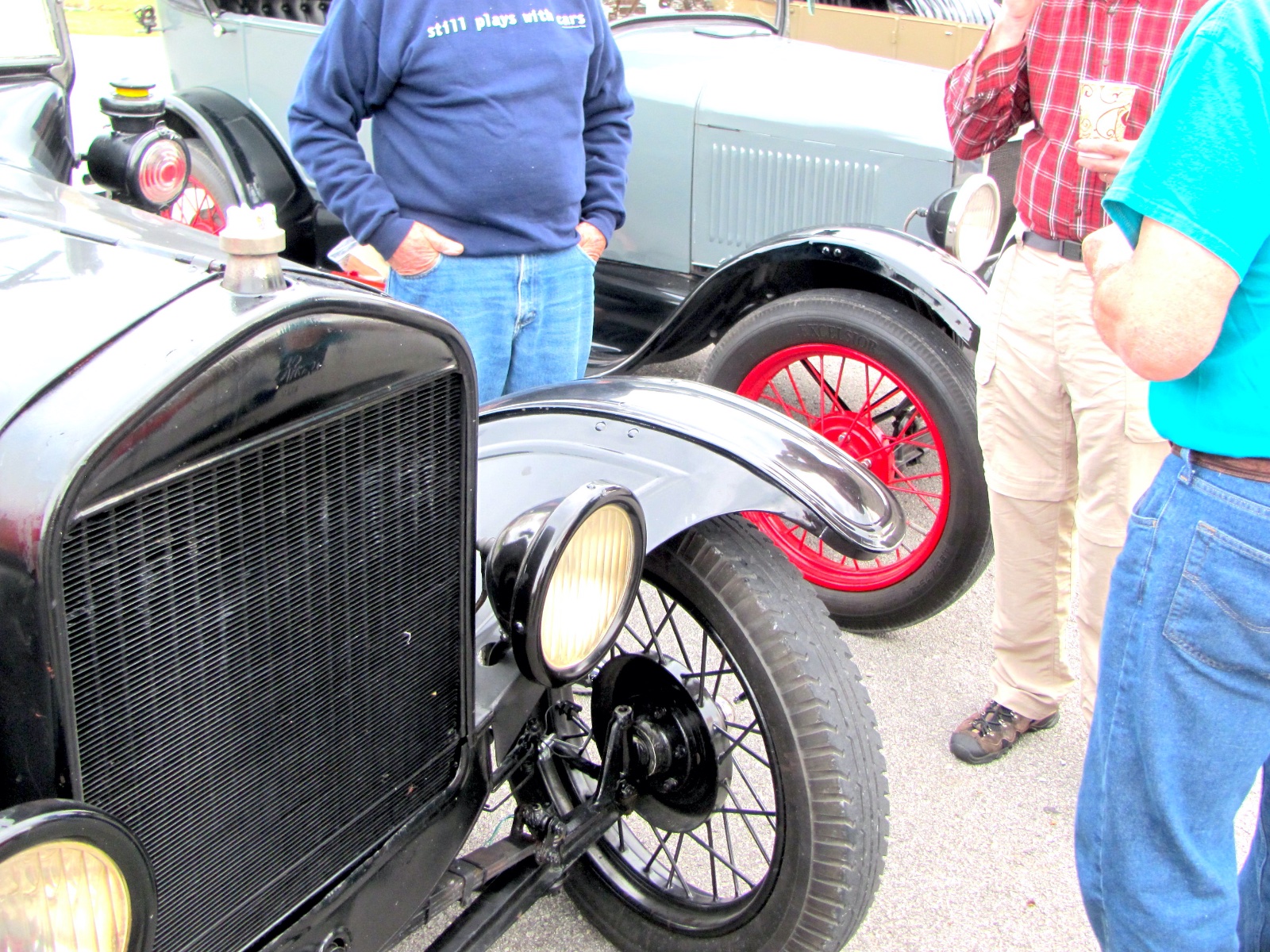

- Posts: 3900
- * REQUIRED* Type and Year of Model Ts owned: ‘12 open express,'23 cutoff, '27 touring
Re: a wheel adaptors
Just a bit of info on adapters for wire wheels. Am believer that Ford engineered the front wire wheels for lateral support with the correct mating hubs.
Model T front hub with long snout and the mating taper 'Dixie cup' like cone of the T wire wheels.
And Model A front hub with brakes, for the Model A wire wheels for contact at the drum and and snout of that hub.
Examined causally this Model T in the foreground on tour a few years ago, my grey touring with red Model T wheels and front hubs in the background.
What I thought was missing oiler for the spindle bolt on this T, was surprised and told the owner, he has a problem.
Closer examination showed his wheels to be Model A with spacers, on the Model T spindle. IMO, suspect the lateral load is too great with offset of the wheel and the lack of support at the end of a wood wheel hub.
The king pin bolt head and about 1" or so below was gone, vibrated away. Only the threaded lower end of the king pin remained in the spindle body, which fortunately could be removed easily for fix.
Lucky to find this out, and brief road repair was made by the owner fitting a longer bolt found at hardware store up the street until proper king pin could be fitted.
Engineer carefully changes, most instances hard to improve on Henry's design.
