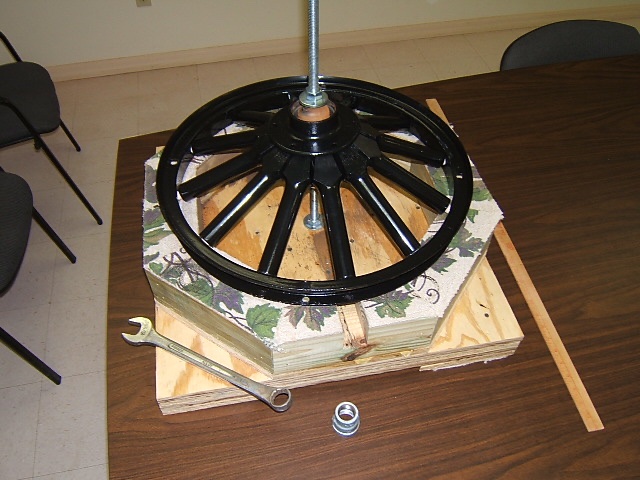

Post by jiminbartow » Fri Dec 06, 2024 12:04 pm
Have you considered doing your own spokes. The only cost is the cost of the spokes. I did my front right wheel 14 years ago and it was actually fun using the Regan Spoke jig. The first wheel will be the most difficult, but once you gain experience, it becomes much easier on the following wheels. Jim Patrick

Post by thom » Fri Dec 06, 2024 4:43 pm
I don't believe it works that way for non-demountables. I'm told they need to be built like buggy or wagon wheels, by a wheel right. If I had demountables I would definitely build them myself. Thanks.

Post by Craig Leach » Fri Dec 06, 2024 5:33 pm
Hi Tom,
I have been here before also & took two different approaches #1 pick up a set of 21" model A wheels ( they are much cheaper than T wires)
Tires are also cheaper. used the T -modem A wheel adaptors, yes they are not cheap. #2 re-spoke the wheels wheels yourself. ( I have put this
on my list of the top 10 things to never do again) I re-spoked the wheels on my firetruck 21" steel fellow demountable, A generous club member
loaned me his Regan press. There are some things you may find in doing this like you may have do a lot of work on the spokes so they fit
correctly not all fellows have the same size tenon hole & it can be a lot of work prepping the whole operation! One of the reasons for doing
the wheels on the firetruck was the age of the wheels & I'm thinking of selling it. That brings us to the next subject liability (I know we are not
suppose to use that kind of language on the forum) I would never sell a Model T with any questionable issues with out a signed & notarized
release of liability & full discloser of anything I was aware of on the car. This is the world we live in now so beware.
