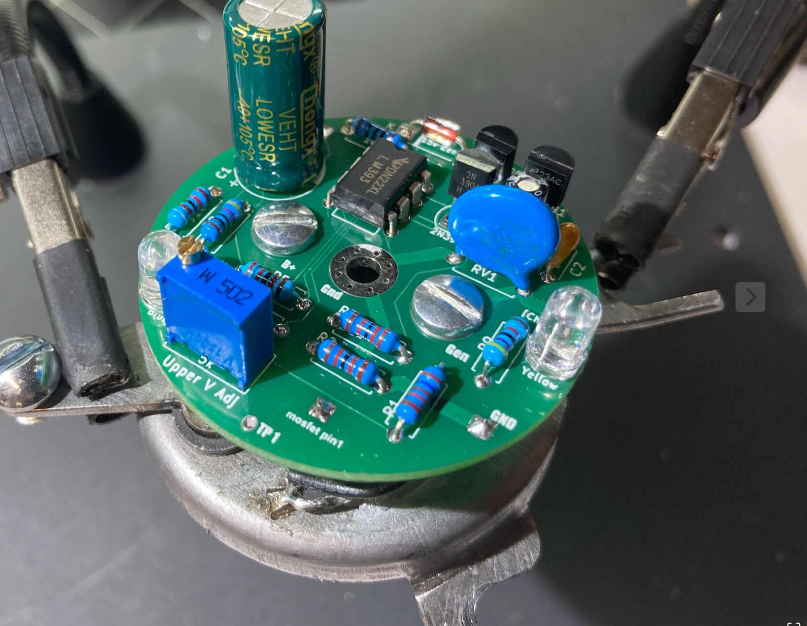

I finally have had time to update the voltage regulator design for 12v cars (Its chilly here in Idaho these days).
Its WORKING perfectly on my test bench. NOTE: if anyone needs an 8 volt version, I can create one of those as well.
It turns ON and starts charging at approximately 12v and turns OFF at 14.0v.
Now I just need to build a few circuit boards with 3 new components.

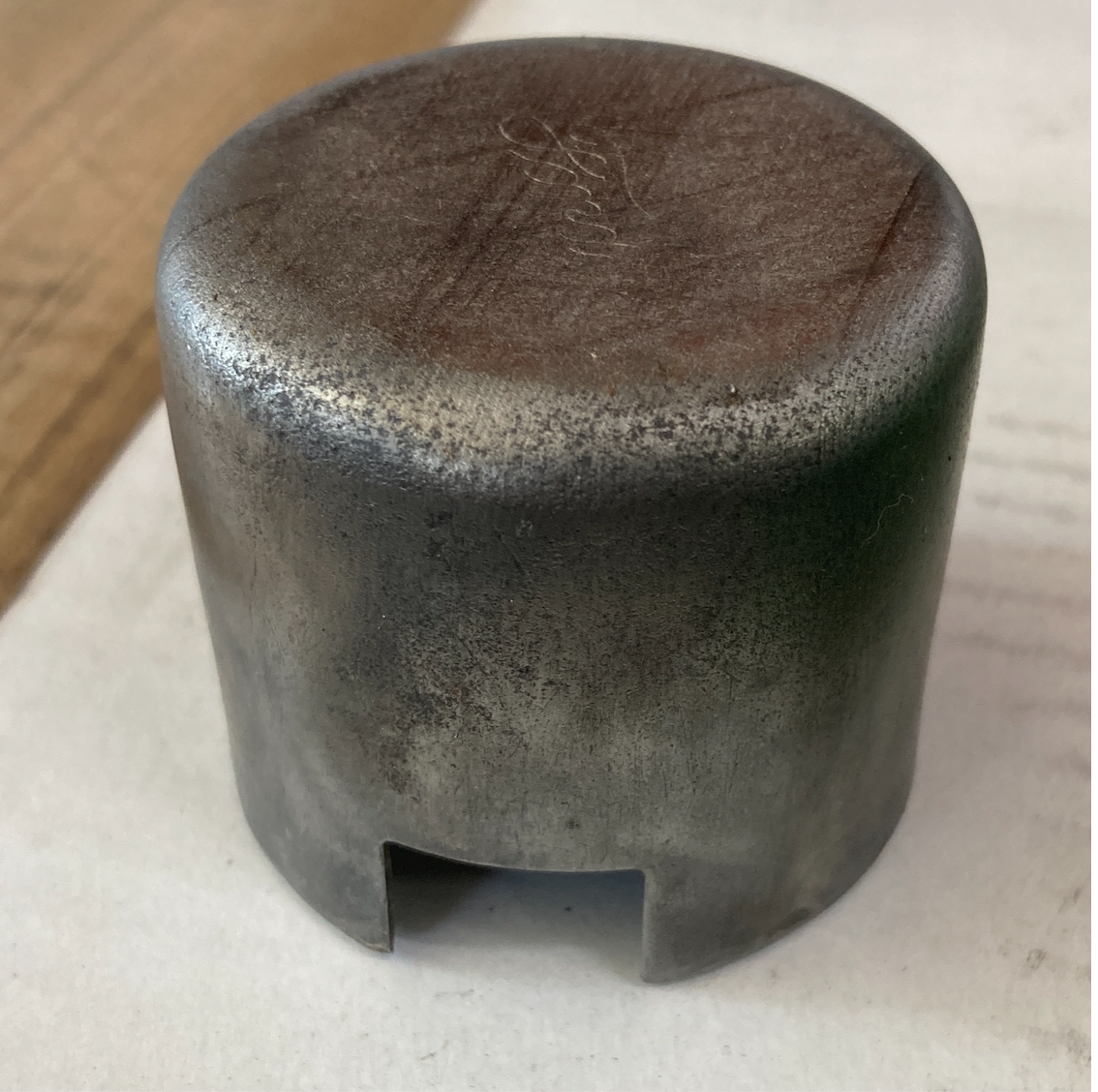

I'm STILL looking for more Cutout cores.... I cant build more of these w/out the cutout tops. ONLY Model T cores (Not Model A) are useful to me. I now have 2 different regulator base sizes so I can take NuRex cutouts, aftermarket cutouts, or any Model T cutout that has RECTANGULAR notches. They all look like this:
