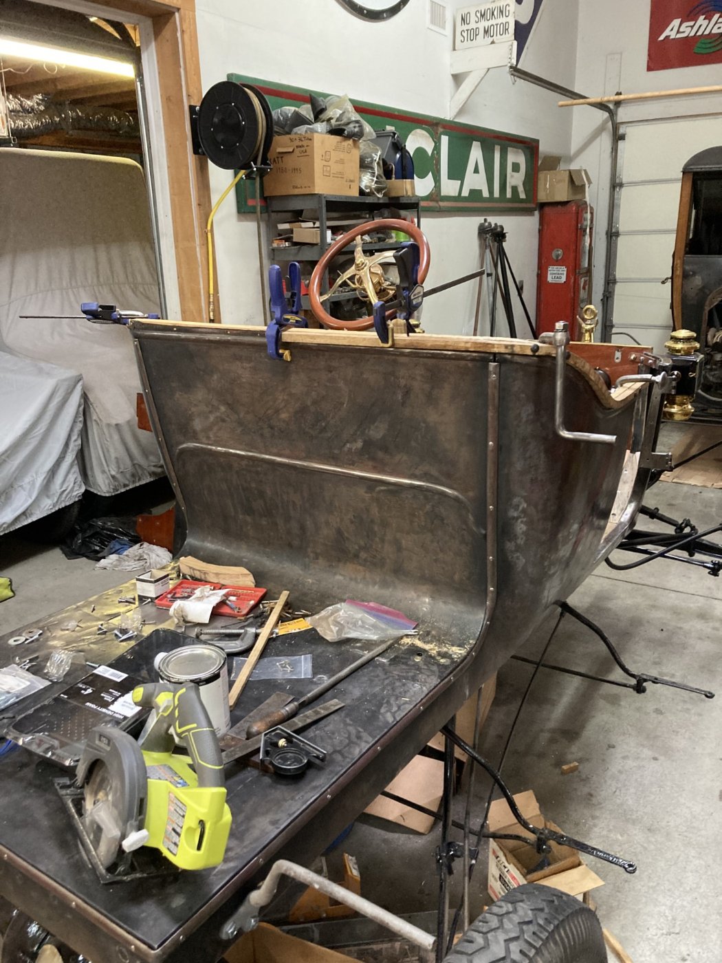

The body moulding on a 1914 is one piece. Here is a photo of the moulding on a Wilson body 1914 runabout

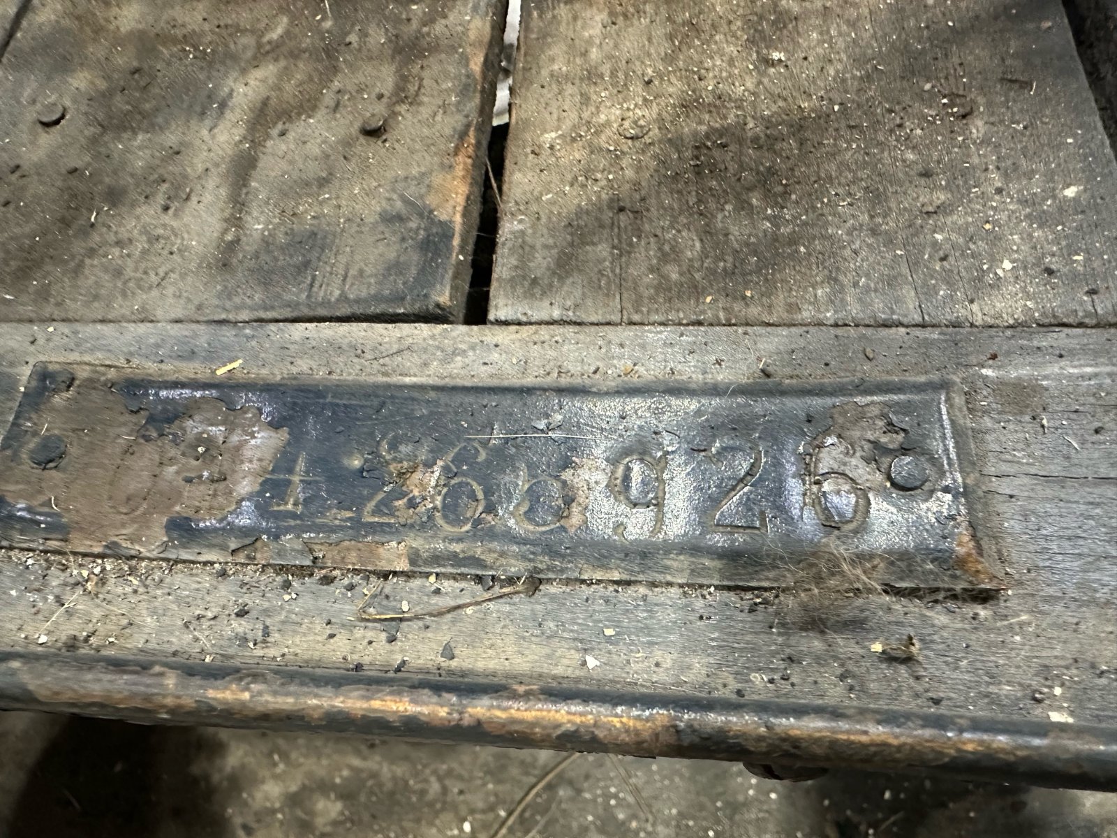

Ty his is the body that came with my 14 project. It is different than what Russ has. I do not know how to determine the body manufacturer. Any thoughts ? Art

On many 1913-14 bodies, there is a letter stamped into the kick plate in front of the gas tank. The 1914 body pictured has a "W" stamped into the kick panel and a "W" stamped into the wood frame that supports the seat springs. Also note the Wilson rear body panel is one piece and goes from the the top of the body to beneath the turtle deck.

Thanks Russ. Mine is B.
