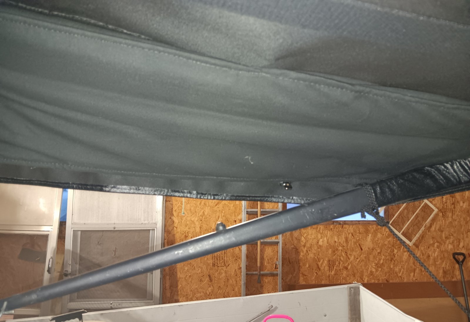

These are all the Fasteners I have so far on the top. The car came with them.

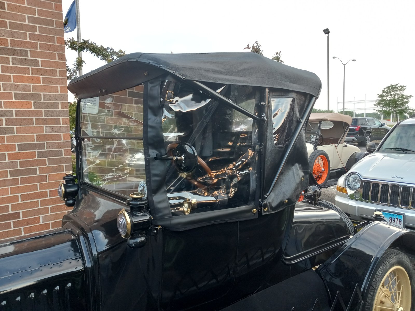

Driving around in an open car with the top up makes me a bit claustrophobic to begin with, side curtains must be like getting an MRI. The attached picture is a NOS set of 17-22 touring side curtains. The windows are way too small for my liking, OK for the driver curtain, but forget about seeing anything thru the passenger side or rear curtains. Those that made their own with extra large windows like Ford eventually did in 1927 is probably the way to go if you plan to use them when driving.
