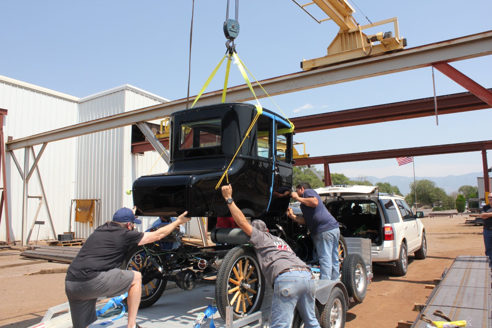

I did my '25 coupe with help of a crane and several guys--needless to say the crane was overkill. It didn't hurt to have a friend who runs a steel fabrication business. I think that four guys plus yourself as a spotter would suffice.

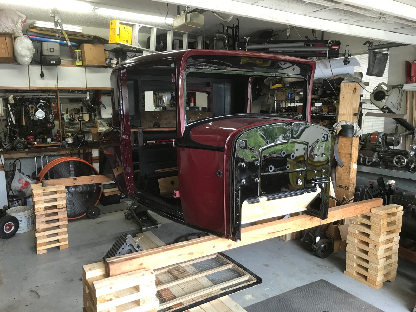

I am 78 and was able to do the body on my 1930 Plymouth myself and it probably weighs 5 time more than a model T runabout body. Four reasonably able guys should make the job easy.

I can really appreciate your cribbing Val !

Steve, the beauty of the blocking I used is that you can easily raise the car one corner at a time adding as you go. The other nice thing is they cost nothing. They were made from scraps that I collected at local building sites.
