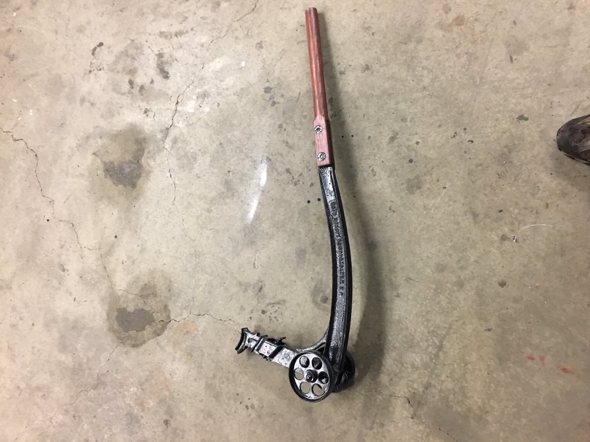

I found this jack some time ago and painted it and put on a new handle. I works well but you'd have to have a pickup to take it along! It was made by J.H. Whetstone in Michigan.
