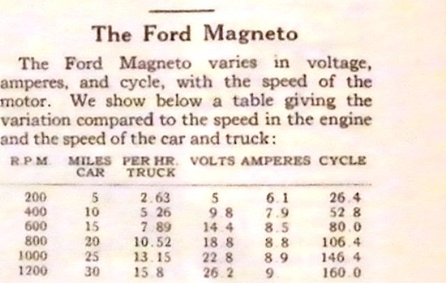

IF LED light bulbs are rated in 6 and 12 volts on a Battery, Generator, or Alternator, What bad results are to be expected when running them on the Magneto voltage of up to 30 volts AC?

Most LED bulbs for automotive would-be DC not AC. You would have to know if they can operate on both and if could handle the variable range of voltage. Battery would for example be 6 volts DC and supplies a more or less continues current and light output, where-as the magneto would be all over the place.

The magneto voltage also varies with engine speed. Would be interesting to see how a variable voltage, AC/DC LED would react
