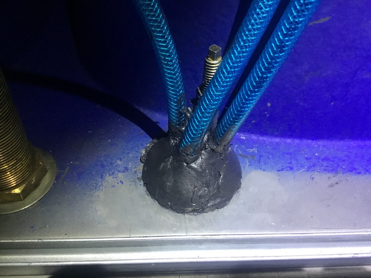

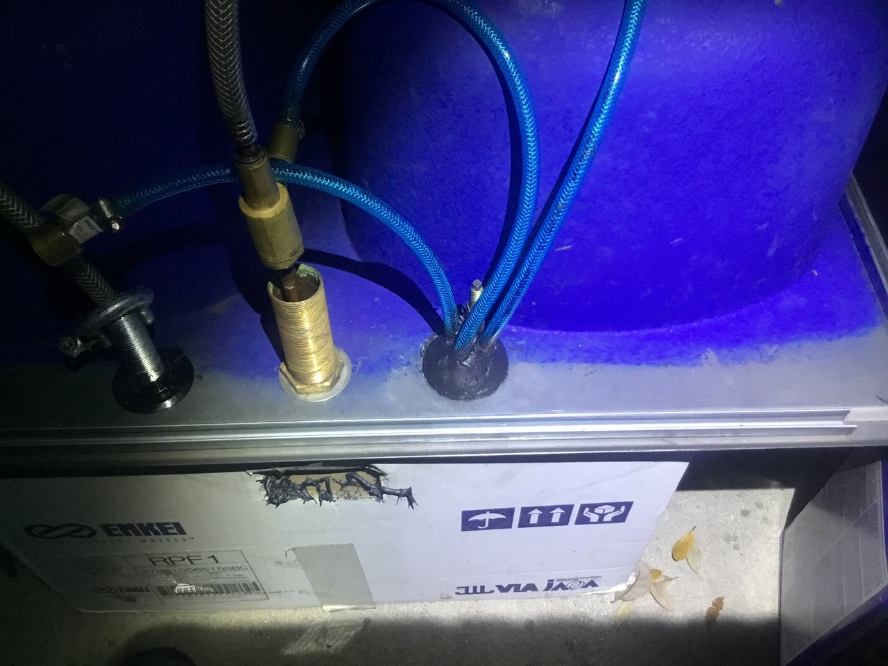

My wife has become attached to an obsolete kitchen faucet that is no longer made and I am trying to salvage it for her to use another 20 years. The three hoses have deteriorated and started leaking, so I made new hoses using new reinforced hoses with the old fittings held on by screw clamps. It took me an hour per fitting (6 hours) to get the six fittings into the end of the hoses using a heat gun. Even then, the fittings are incredibly tight, so I’m pretty sure the clamps and fittings will hold but, to be sure, I encased the cluster of hoses in The Right Stuff. I’m just hoping the mound of the Right Stuff is not so thick that the center never cures. That was my question. I don’t believe this is an OT posting since many of us use The Right Stuff on our T’ and the answer to this question may be useful for some of those applications. Jim Patrick

Exactly, Gene. The clamps, fittings and hose ends are fully encased in the Right Stuff. What you said is encouraging. When I went out to take the pictures at about 11:00pm, the mound of the Right Stuff I packed around the bundle of hoses, was very firm. I applied it around 5:00pm this afternoon so it has been around 7 hours. I’ll be a hero if I can save my wife’s faucet, LOL. I can see why she likes it so much. After 20 years it still looks brand new and they don’t make ‘em like that anymore. Jim Patrick
PS. When forming the Right Stuff, have a cup of water handy and with a wet finger, tap it smooth and gently smooth it before it cures and you can get it pretty smooth. I’ll probably give it a week to cure before hooking it up to the water and testing it, just to be sure the core is fully cured.

I agree a 2 part epoxy like JB Weld would cure from the inside out, but, if for some reason, I am unable to salvage the faucet and need to install a new faucet, JB Weld would be almost impossible to remove.
I checked my mound of the Right Stuff at noon today, after applying 19hrs. ago and the outside layer (I estimate about 1/8” deep) is firm, but the inside feels soft and uncured. Do you figure it will cure better in the heat of the sun? Jim Patrick

43 hour after application at 5:00pm on Feb 2, the outer layer is quite a bit firmer and thicker and the interior not quite so squishy. I think it will totally cure eventually but it’s going to take a few days. Probably at least a week. Jim Patrick

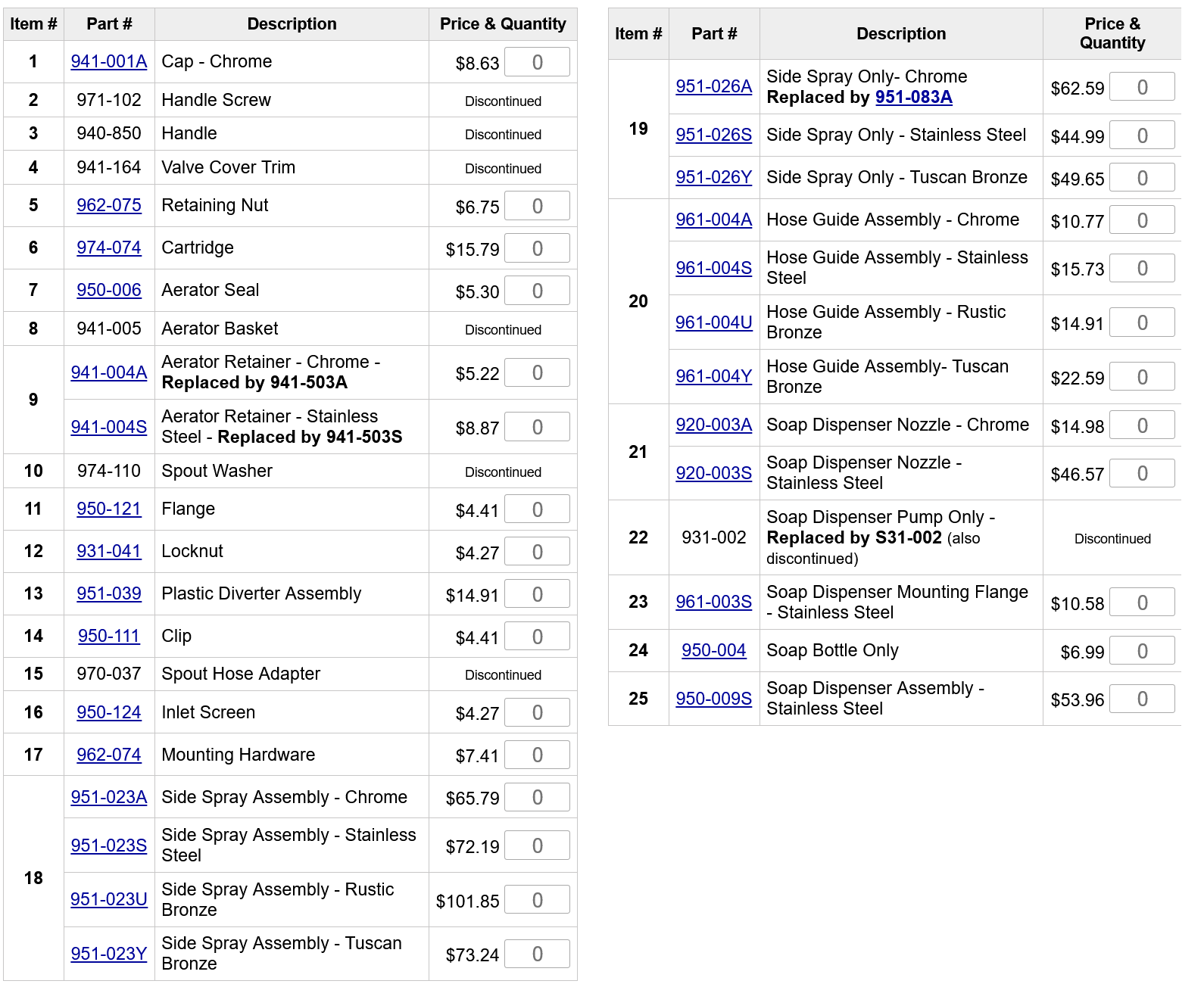

The faucet is not so obsolete as you may think. Thought you might want ti know where the parts are.
https://www.plumbingsupply.com/pp-kitch ... ielle.html
I wouldn't use J-weld in case you need to get at the hose connections later.
I wasn't able to ID the proper hose & they are pricey. There are several on out there. https://www.bing.com/search?q=hose+for+ ... cc=0&ghpl=
