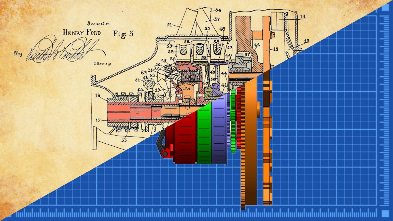

I haven't been called an "artificial idiot" yet, but there is still time. (How the Model T Transmission Works - youtube video by me.)
https://youtu.be/jsaRIrJX-NE

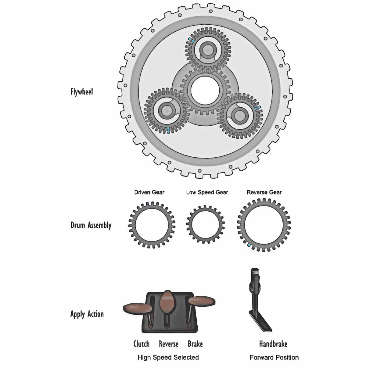

I would like to announce that after a great deal of tinkering with code, the Model T Transmission Simulator is working again!
https://www.fordmodelt.net/transmission-simulator.htm
A small disclaimer though, the simulator uses an outdated media format called Shockwave Flash and may contain errors. It's using some clever behind-the-scenes coding trickery to make the original simulator come to life - so please persevere with it!

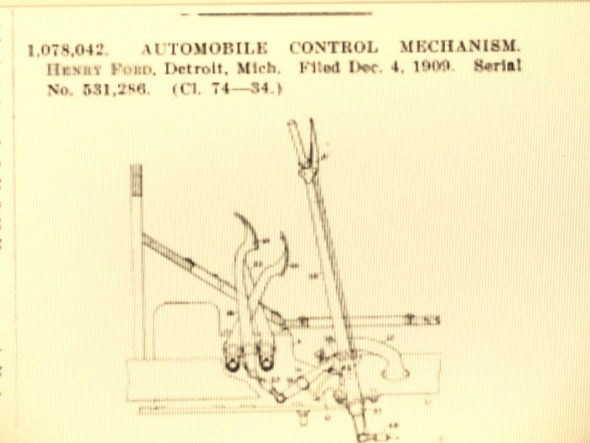

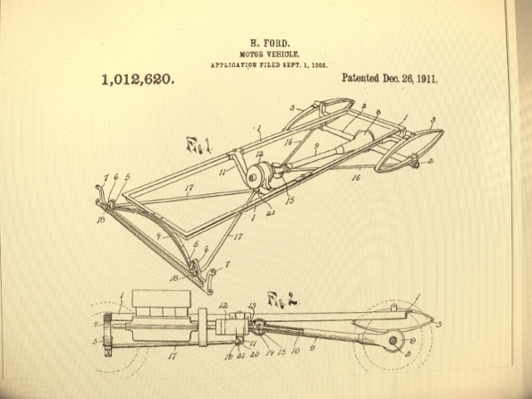

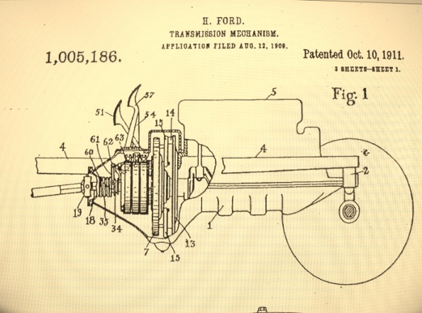

Question. Did Henry Ford actually invent the Model T's transmission?
- Posts: 4084
Re: AI Explanation of how the Model T transmission Works
Mr. Henry Ford did it.
- Posts: 4472
The planetary transmission was not a new thing when the Model T came about. All the early Fords used it, as well as many other makes. I'm sure the patents shown above are for some unique features specific to the Model T. So, if your question was, "Did Henry Ford invent the planetary transmission?", I would argue the he did not. Did he, (and his team), design novel and unique differences in the use of the planetary transmission for the Model T Ford, I would say that yes, he did.

I a'm not trying to start an argument, but I was told that the only thing that Henry invented was the charcoal BRIQUETTE. He was most credited for improving the modern assembly line. He did assemble all the engineers who invented the model T's transmission but no one man was credited.

I agree with Jerry. Henry Ford was a talented farm kid and an excellent businessman. He developed the concepts and oversaw the details but he wasn't an engineer. One of his key engineers that joined Ford in 1905 was Jozsef Galamb and he worked in the backroom at the Piquette Plant with other engineers turning H.Fords' ideas into blueprints and patented projects. LIke most other successful businesses and corporate endeavors there is always a lot of hard working people behind the scenes that make things happen.

The Model T transmission simulator on modeltcentral.com no longer works.
I have re-engineered it on my own website so it works again
