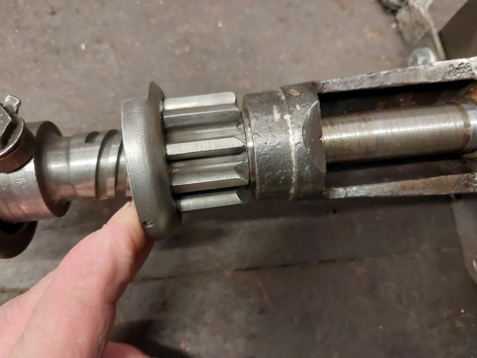

I'm also in the process of setting up two starters. On one I noticed that the Bendix gear hits the starter motor housing. I set the endgame so that I have some distance there. I would be interested in other opinions on this.
greetings from Switzerland
