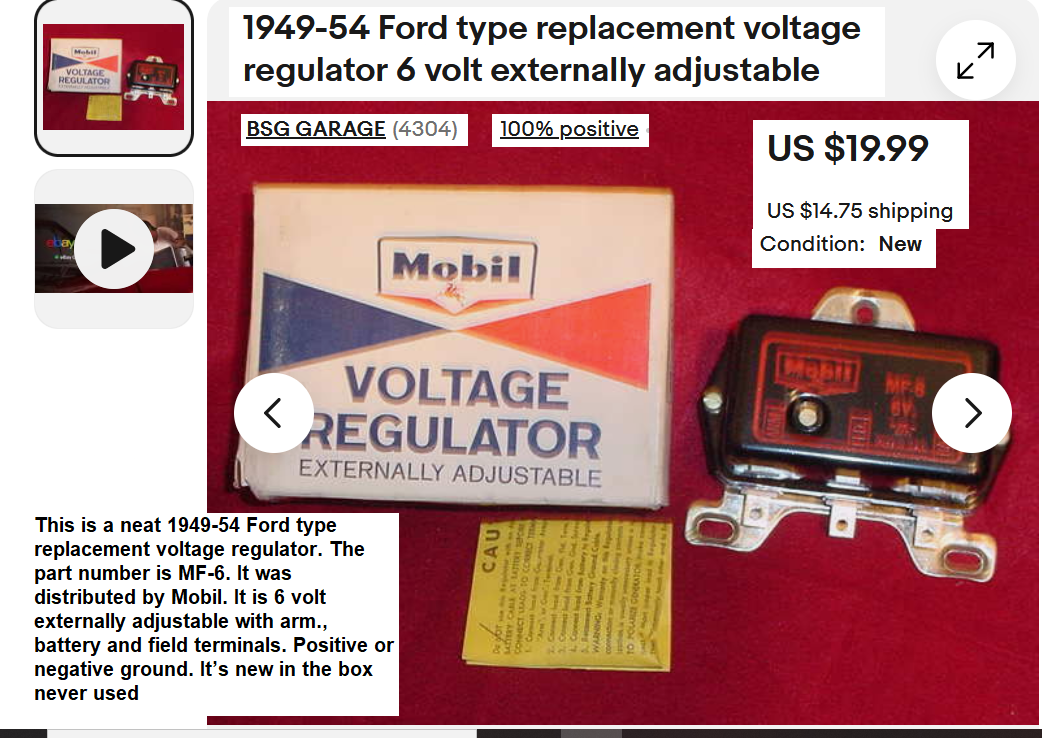

Why not buy one made for your 1949 F100 https://www.google.com/search?client=fi ... 9++49+F100
If you don't trust eBay then local Parts Suppliers would be able to get one
Model T VR's are currently being made by our forum Admin www.modeltregulators.com
