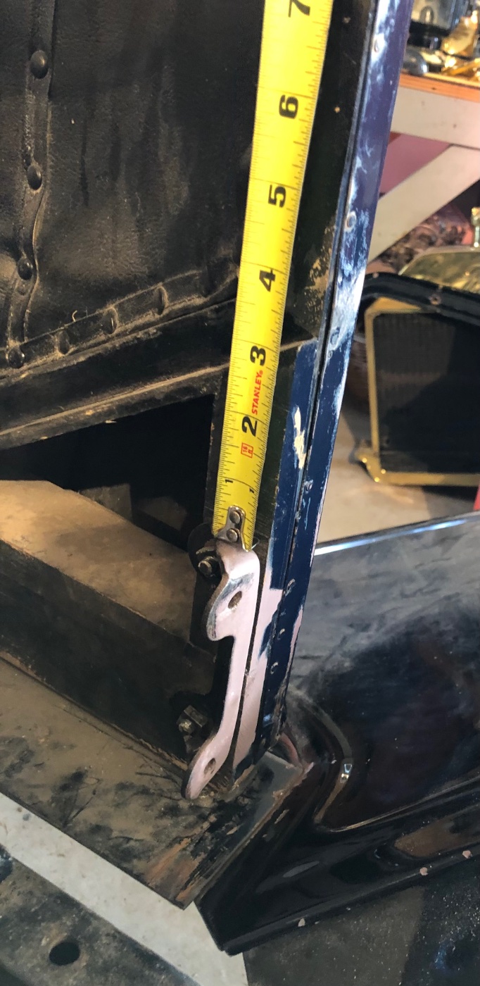

Post by Rich P. Bingham » Sun Feb 25, 2024 7:04 pm
Perhaps this will help ? The brackets are 3" below the upper edge of the floorboard riser.
