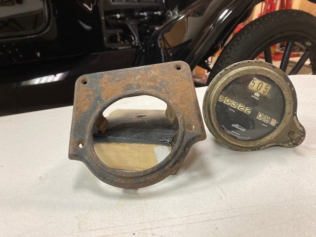

Topic author - Posts: 472
- Joined: Thu Jan 10, 2019 12:56 pm
- First Name: Robert
- Last Name: Brough
- * REQUIRED* Type and Year of Model Ts owned: 1915 War Wagon 1927 Depot Hack 1927 TT
- Location: Winston, GA
Re: WTB hole filler speedo and accessory dash light.
I'm baaaaaack....
Trying to figure out how to mount square speedo into round hole. Well, not exactly, received a Stewart speedo with a mounting plate and would like to install it for appearance only. Round hole in metal dash has no drilled holes, so I know some drilling is in my future. But, speedo has offset odometer reset knob that needs to be accounted four. There is a faceplate/bezel that may come off the speedo and than reinstalled after passing the sppedo through the back of the metal panel. But I'm just not picturing how this speedo gets sandwiched with the mounting plate and the detal dash panel and in what order do items get installed?
I can remove the dash panel from the firewall and mount on the bench and it will not be functional. But I don't want to start prying apart glass and bezels that should not be pryed apart.
Any guideance appreciated . I can take a pick of the speedo and mounting plate, but this dash panel in this thread is what I am using.
Thanks in advance. I realize I am probably using speedo salad and Frankendash, but I'm using what I have, not what I can purchase.
A bunch of old cars
Sometimes they run.
Sometimes, they don't.
A bunch of old cars
Sometimes they run.
- Posts: 6394
Remove the the nickle bezel & the trip odometer external parts (don't need since speedo is for looks) to see how things will fit in the bracket or the dash. You can make an L shaped bracket to hold the speedo to the dash or bracket using the screw positions that were for the nickle bezel
