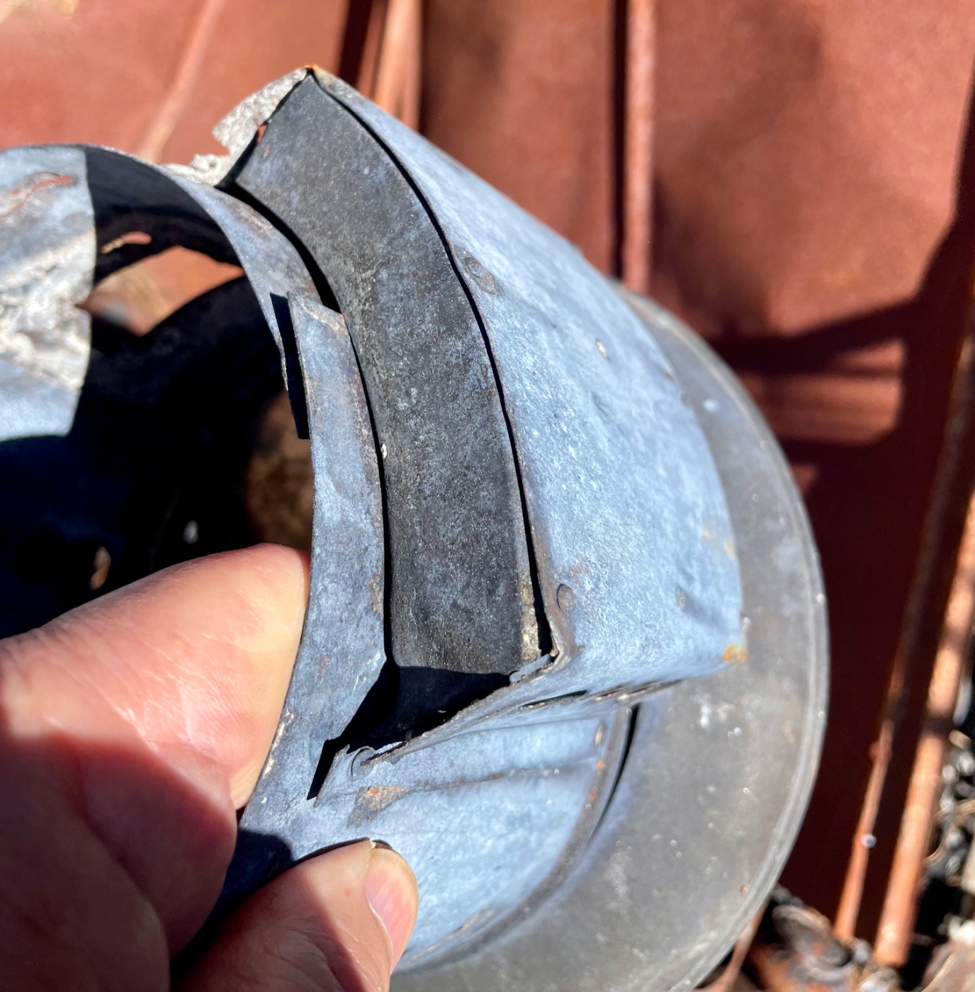

Some of the other knockoffs.

Here are a couple photos of mine. They have mirrors and the retainers are soldered in. attachment=2]20240310_131709.jpg[/attachment]

Post by JTT3 » Sun Mar 10, 2024 6:29 pm
Your Legit
