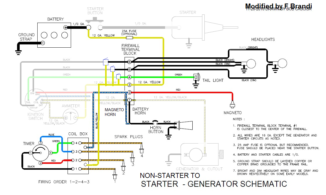

I created a wiring diagram as a starter as you described and how it could be updated later. Input from others welcome
Best to get the wiring harnesses for the later diagram.
diagram shows the optional horn wiring
Just because there is a post on the back of the box for BAT doesn't mean its wired up.

Post by ryanf1023 » Thu Mar 14, 2024 3:46 pm
I appreciate you drawing that out. It looks like I don’t have to modify it as much as I first thought.

Post by TRDxB2 » Thu Mar 14, 2024 4:21 pm
Keeping the wiring pr the diagram will take a lot of guess work out of any future changes by you or anyone else. The terminal block eliminates splices and uses standard harnesses. Lots of pros & cons on 12 volt setups. How do you intend to charge your battery via MAG kit or smart trickle charger? These 6v-12v headlight bulbs are now the rage. No need for good reflectors
