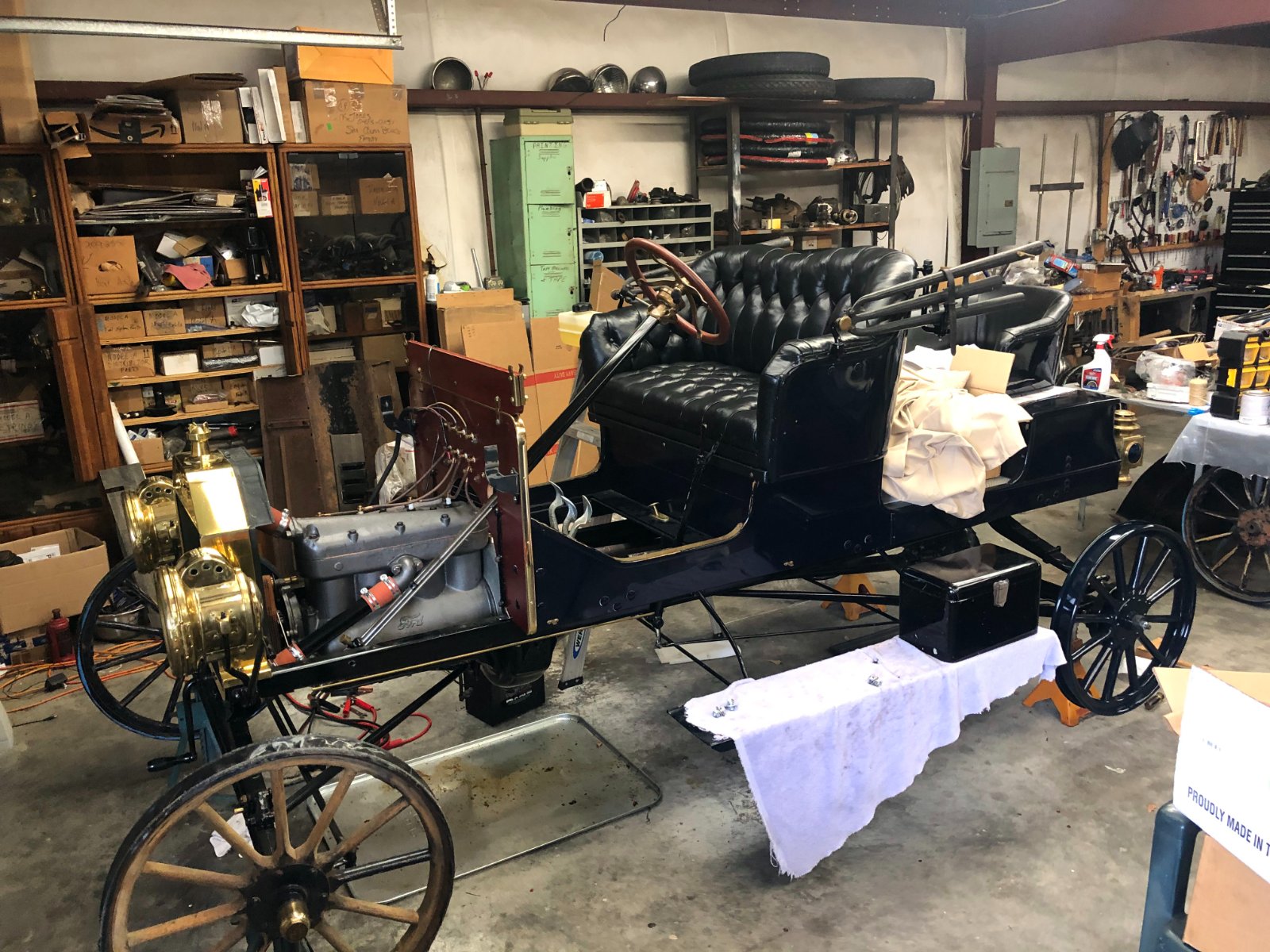

I have run up against something that is puzzling me on my 1912 Runabout (pictured) which I am re-restoring. Trying to get everything mechanically "just right" before I put sheet metal back on. I went through the rear axle brakes and got them cleaned up and set right. Then when I went to put the wheels on, one side did not "go on all the way" as shown in the pictures. So I did some measurements and the side that fits correctly (the left side), the axle shaft protrudes about 3/16" further out of the axle housing then the right side (I might have the sides mixed up as I think about it nonetheless one shaft protrudes 3/16" out of the axle tube more than the other). On the right side, this results in the hub not fitting squarely around the brake shoes. What am I missing here? I thought all axles were the same, with the exception of the very early T's. Maybe something not set up right inside the rear axle? It is a 1912 axle. Maybe I am just exposing my ignorance, but hopefully someone could tell me what my issue is. I am starting to think this rear axle will wind up being pulled and gone through just like I did with the engine to make sure it is set up right.

If I had built that rear axle and found the drums parked off the backing plates as they are, I would be delighted. It would indicate to me that the wheel hubs and axle tapers were hardly worn at all. It may indicate that one of the axles is a new longer one to compensate for wear. However, if it makes you feel more confident that all is right, now would be the time to split it and be re-assured.

What I see in the photos wouldnt bother me.

As for how they look in your photos? As long as I know the gears are set up correctly and properly centered? And as long as at that point they are tight on the axles and still turn freely? The photos look okay to me.
