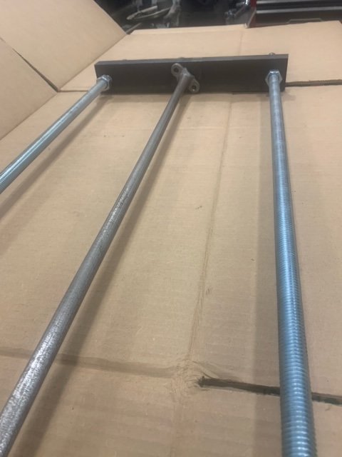

The drag link can be straightened. Never beat it or you could work harden the metal. First, I use my press to get it visually straight and then I use the bench mount press I made for the small bends.
I use a light spatter of quick dry paint and a long sanding block to indicate the bends. I move the small blocks narrow or wide to fit the sharpness of the bend.

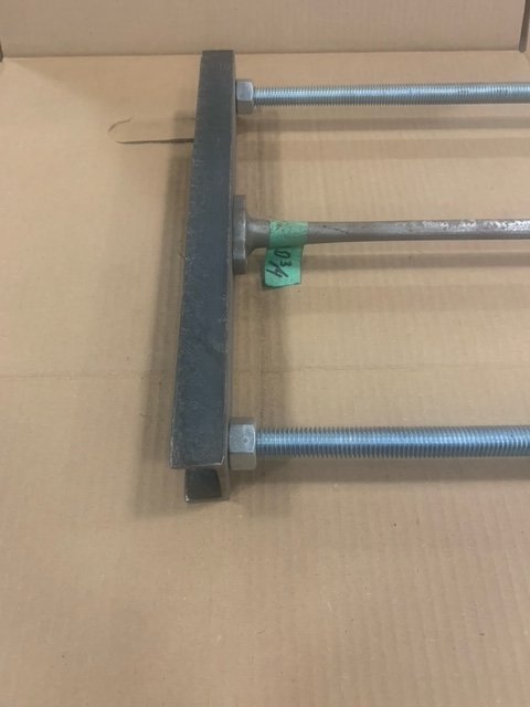

For the ends, I mount it in the frame with one end fixed and the other threaded end for pulling the ends to parallel to each other. You can reverse mount it in the frame to correct the opposite end.
As the drag link ends are 45 degrees to each other, to correct the twist, mount both ends solid in the frame and leave the working threads loose on adjustment end so you can twist the frame until it sits flat on the work bench.

If I may add, I can straighten yours for you. You can contact me by email and I will reply.
Ken

Re: Can this drag link be straightened?
Nice jig there, Ken !
