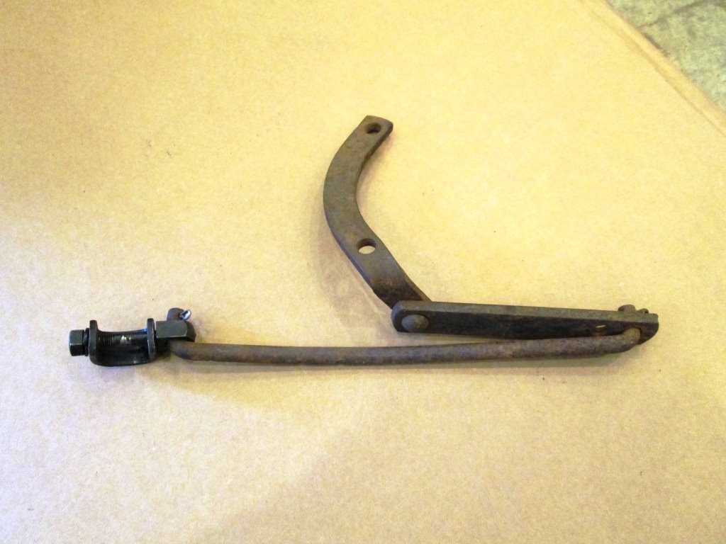

I'll get a photo of my original R.M pedal linkage later today & post it.

Post by RajoRacer » Mon Jun 03, 2019 8:57 pm
Here's what an original R.M. brake pedal clamp & linkage looks like.

Post by Dallas Landers » Mon Jun 03, 2019 9:20 pm
Thank you Steve. I think even I could make that.

Steve: I sure wish I had those parts you just posted. Those kind of parts probably got scrapped by the 100's because no one knew what they were for!
Not to commit someone else to a job but I’m sure a bunch of folks around here could whip up copies of those in their sleep.
