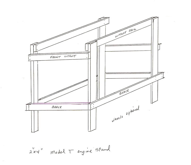

Re: Two Questions . . .
Using the same height and width dimensions as the frame, I made one out of 2”x 4”s which served me well. Assembled using 2 1/2” drywall screws, I made it waist high so it made working on the engine very easy. Very sturdy and hardly cost anything. When I was done, I disassembled it and used the lumber on other projects. No storage room needed. Jim Patrick
