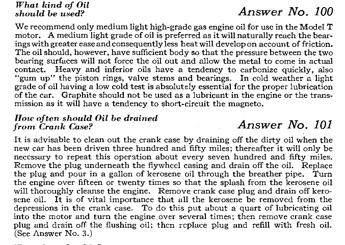

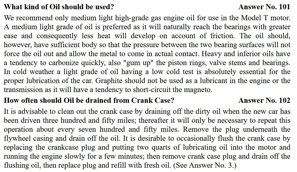

If you have or intended to have the Magneto - you do not want any "additive" in the oil that is conductive. Graphite or zinc as can short out the mag post. There are always discussion about detergent & non-detergent oil & resulting slug build up. If you have never dropped the inspection cover on the transmission pan - now's a good time.
The original spec for model T was a light oil but engines have been modified and as a result owners have chosen an oil to meet their mods. As a result numerous recommendations.
Mobiloil "E" was a 20W oil - As recommended above, the least expensive 10w-30 is all that's needed. Expensive motor oils are for today's engine RPM's & tolerances.
