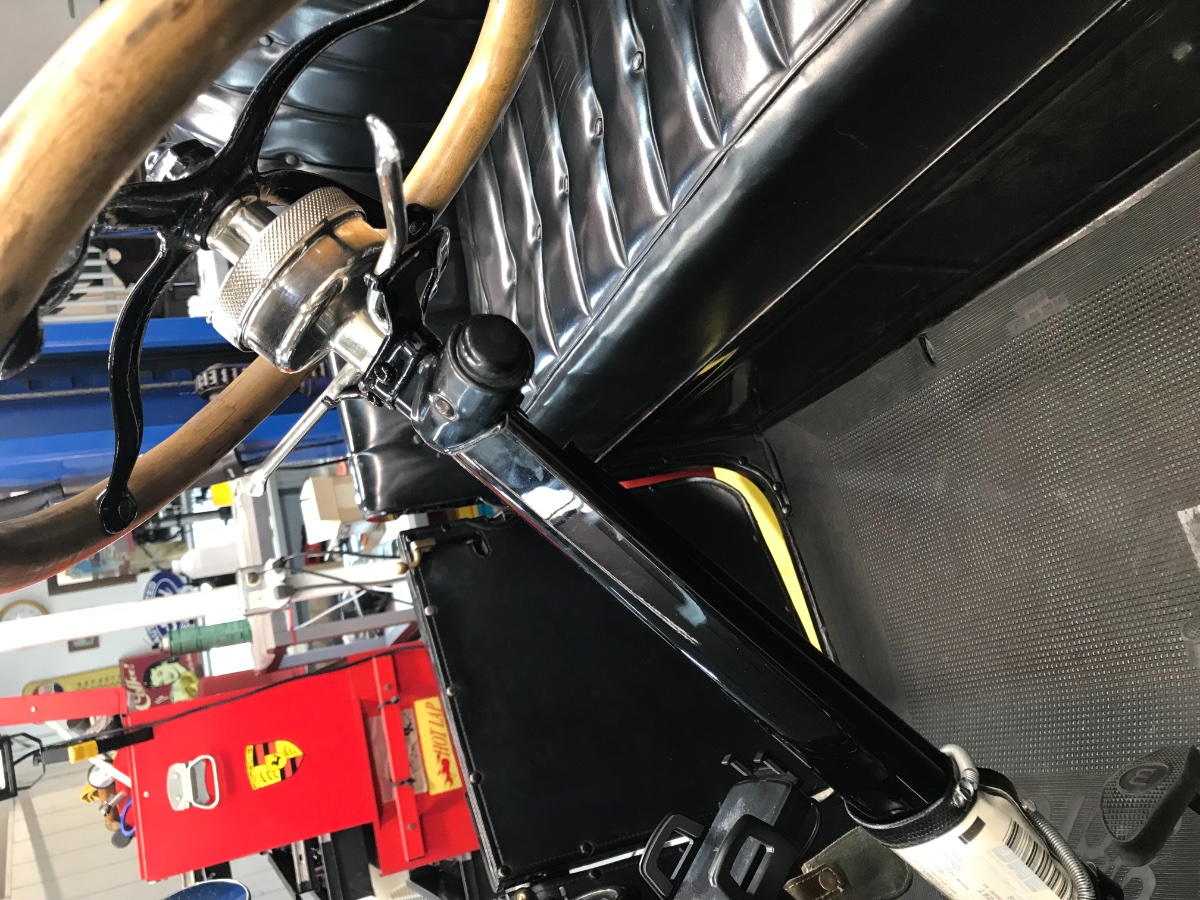

Finally I have cracked the code to tight steering. The new refurbed column I got from the swap meet did the trick. Not an easy change to r&r the whole column but it needed to be done.
The last 2 culprits were the steering shaft itself and the gear housing. It turns out my planetary gear pins had completely worn out the receiving holes - to the point they wobbled in place. Which also caused excess wear on the brass housing gear. Together this caused a ton of slop in the wheel. All the other components had been refurbed, this was the last piece.
My test drive tonight was amazing... it’s a whole new car. Zero play now and it goes right where I Point it. Now it’s time for Touring!

Yup... just got home this afternoon and tackled it first thing. I’ll put in the new head tomorrow!
An added improvement is the new quadrant on the refurb column actually works. The levers actually stay where you put them. So that’s how that’s supposed to work. My old one was totally worn out. Interesting that you can’t buy repos of the non-brass quadrants.
