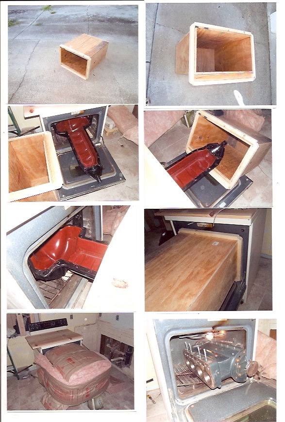

jiminbartow
Posts: 2468
Last Name: Patrick
Location: Bartow, FL
Re: Rusty pan
Post by jiminbartow » Thu Apr 04, 2024 11:35 pm
Yes. When I overhauled my engine in 2010, after thoroughly cleaning my disassembled engine, removing all oil residue, dirt and traces of rust, I brush painted Glyptal on the interior of the block, interior of the hogshead and the interior of the oil pan and according to the instructions, baked it on for several hours in an oven. The Glyptal is still there doing the job I intended it to do. Helps the oil to flow off of the interior walls, prevents the oil sludge from sticking to the walls and brightens the interior of the engine, making it easier to see what you are working on. Coating engine interiors with Glyptal was very common among the forum members years ago and I am surprised more of the old timers here have not spoken up about it. I think it was also common in the racing industry. Jim Patrick
PS. DO NOT PAINT OVER RUST. It should ALWAYS be removed whether painting or not. I use muriatic acid to remove rust and after all the rust is removed down to the bare white metal, I thoroughly neutralize with a strong solution of bicarbonate of soda (baking soda).

James neat oven mod. Bill a guy I worked with knew I had worked on a powder coating oven asked how to make a oven for doing small parts.
I suggested he by a oven from the used appliance store. He came home with a old bakery oven that was very large for the same price as a
regular kitchen oven.
