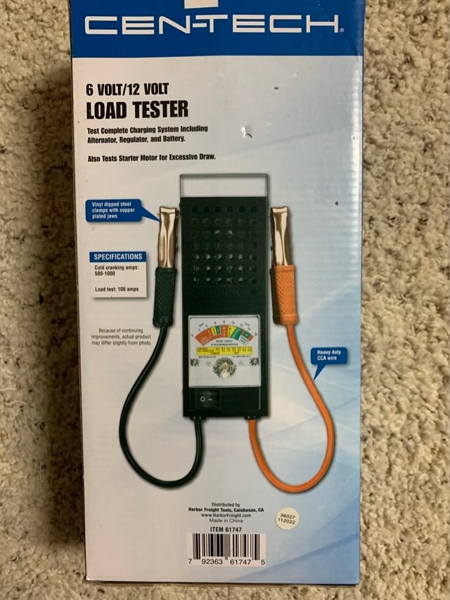

speedytinc wrote:
Tue Mar 26, 2024 4:52 pm
Battery load tester.
No car owner should be without one.
Recommendations on which one to get?
Posts: 5021
First Name: john
Last Name: karvaly
Location: orange, ca
Re: Everything quit
Post by speedytinc » Tue Mar 26, 2024 6:59 pm
vping wrote:
Tue Mar 26, 2024 6:35 pm
Mine is an old American made unit.
ebay : "6V 12V Car Battery Load Tester Voltmeter 100Amp Analyzer 5 Seconds Fast Test"
I would go with this king of analog tester over a cheaper electronic unit.

I highly recommend the Harbor Freight Centec load tester. It will give you quick look at your battery condition.
