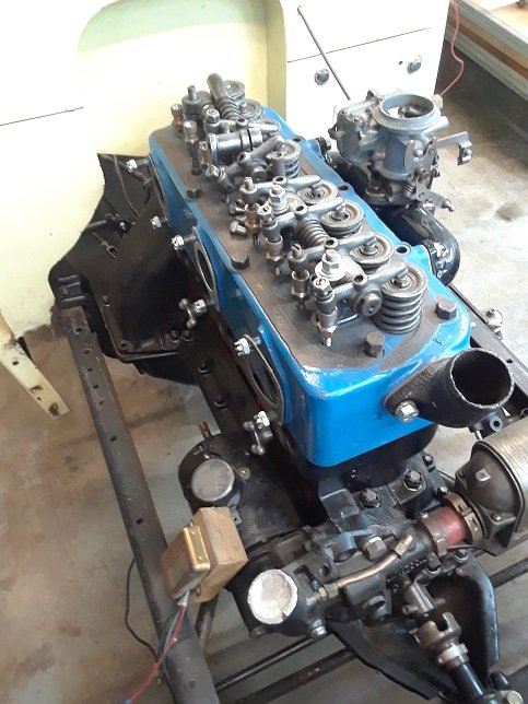

here are a few pictures of questioned head, as you can see the valve cover says Frontenac, which fits the head perfect, the exhaust manifold says Roof 8, and fits the head perfect, but the head is supposedly a Rajo, so what is the correct item manufacture. I really need a rocker arm for this engine and am having a bit of a issue determining what it really is.

Your overhead is not a Rajo. I believe it is a two port 8 valve Roof head , but I don’t know what model name Roof used for it. The valve rockers you show may or may not be Roof rockers, but if they are Roof it will be very hard to find replacements. You may have to replace all 8 rockers and make new rocker stands. I looks like it is a nice running head.

Definitely a Roof 2 port, same as I have pictured above. The 1/8” pipe plugs above the intake ports and the 3 freeze plugs in the top are dead giveaways. That is an interesting variation of the exhaust manifold as it has the Roof name cast in.
The head that I have pictured above was acquired after many years of searching… only to find that the casting design is poor at best. My advice is to run a good water pump (not just a typical circulator) and keep the power output fairly low. Heat buildup will be its ruin! There is no water between the port floors and combustion chamber, just a thin web of iron that is too thin to take a valve insert. Rebuilding will take some creativity. Also, ditch those exhaust gaskets! Get some high temp silicone and prevent the ear breakage that is sure to come

Yes, definitely a Roof head with a Fronty cover. Good running head with a little added compression. Unfortunately as Kevin mentions above the port / chamber roof design is not very robust and really the only way to salvage a head with bad seats is welding.

good to find out what this thing really is. as for the rocker arms they seem to be not 1:1 but, maybe these are not the right ones.

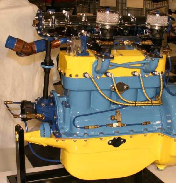

Here is a photo from the Bill Smith collection of a Roof 8 valve head converted to overhead cam. The front and rear of the head has had holes drilled and plugged for water passages.
