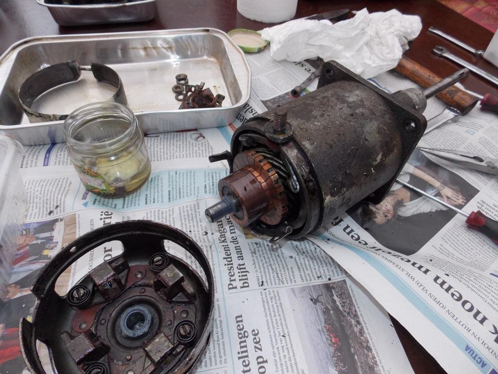

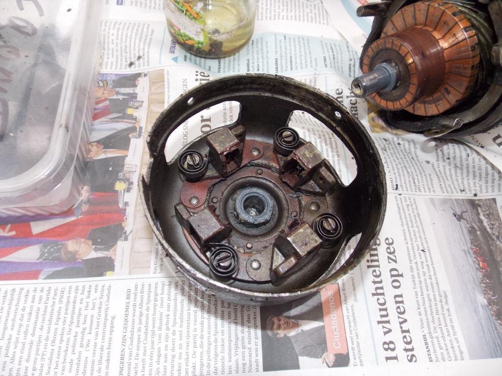

Post by AndreFordT » Fri Jun 07, 2019 6:22 am
Sometimes a starter look like this. With a 12V battery it may be working but with a 6V battery it will be an other question.
Good luck
