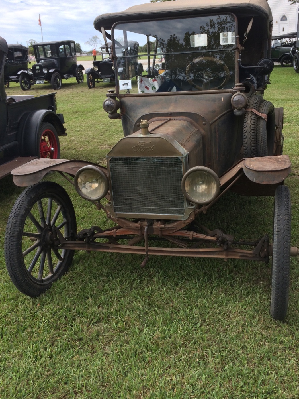

Post by George House » Thu May 16, 2024 6:33 pm
Ever seen an original ‘15 wide track with 2 rear ‘lites’?
