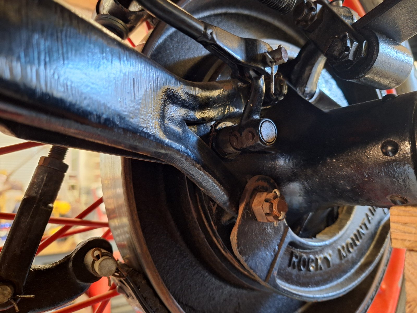

The equalizer pictured above is Rocky Mountain. I used to have a NOS A.C. equalizer, but don't any more. It is smaller than the RM but does the same job. Someone must have an original AC unit?

I got my AC brakes from Daniel Bennett. He provided all the hardware and the special pedal. Unfortunately, I haven't yet installed them.

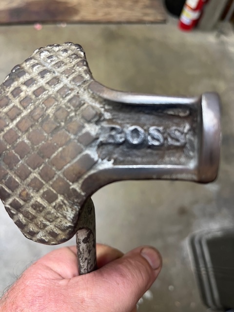

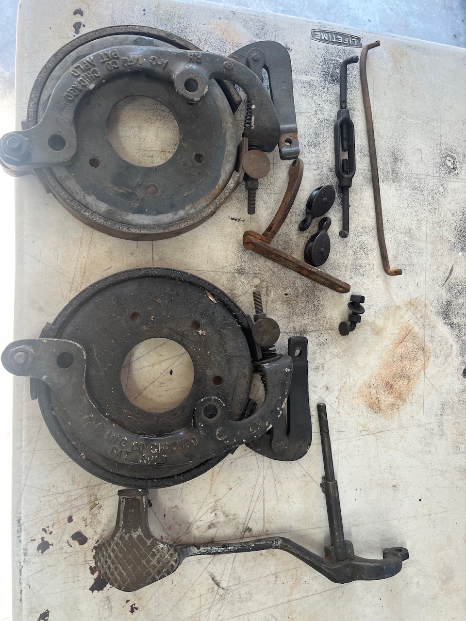

I have this set of original AC brakes, not sure if everything is here, someday I’ll get around to using them.
Posts: 1529
First Name: Keith
Last Name: Townsend
Location: Gresham, Orygun
Re: New AC brakes available now?
Post by KWTownsend » Thu Dec 19, 2024 4:38 pm
Kim,
Is that an AC brake pedal or a pedal from a different manufacturer?
Dan McEachern
Posts: 1512
First Name: DAN
Last Name: MCEACHERN
Location: ALAMEDA,CA,USA
Post by Dan McEachern » Thu Dec 19, 2024 5:16 pm
Keith's observation is correct- that is not an AC pedal. Original AC brakes used a clamp on bracket that installed on the pedal shank just above the pedal shaft to provide an attachment point for the rod that pulled the equalizer assembly. The pedal shown has a lower arm that pushes toward the rear- the wrong direction if used for AC brakes. Most pedals like this are used with an equalizer assembly that clamped around the emergency brake shaft such as Bennet brakes and the pivot point of the bracket reversed this push motion into a pull motion to operate the rear brakes.
KimDobbins
Posts: 1711
First Name: Kim
Last Name: Dobbins
Location: Southern California
Post by KimDobbins » Thu Dec 19, 2024 5:21 pm
The pedal says ROSS
