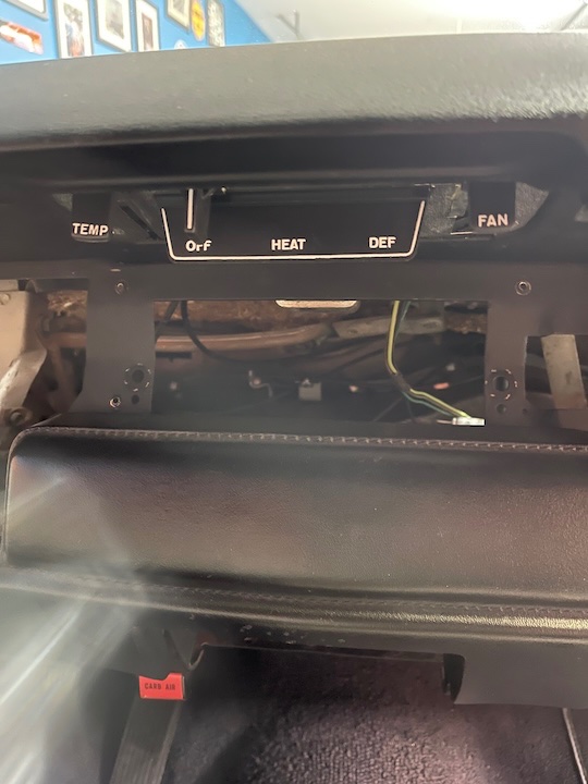

One day we were out driving and my daughter said "I smell electrical."  We were pulling into the driveway and sure enough the horn connection under the hood was melted.  Upon further inspection we found that the area where the wires go through the firewall were also melted.  It was time to rewire the car.  We had the gauges redone as well by Instrument Specialties.  Well fast forward (2 years Ouch!) we are now putting it all together.
Here is the dash being done. Yes we used my wife's sewing room. Ha!!
Angie got real good at tracing wires in the shop manual.
We also got the heater controls redone. these usually have the paint worn off.
Then she connected the defroster vents.
Next we will put the gauges in. I have to hurry she got another scholarship from the Air Force to study Japanese at a summer school so she leaves in a week.

Well we got it all in and everything worked except the horn.  That's where it melted the first time.  I can hear the horn relay go off so I'm going to take a working horn from my 67 Charger and see if the horns got fried as well.
