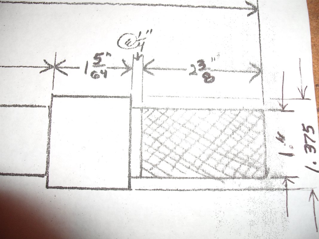

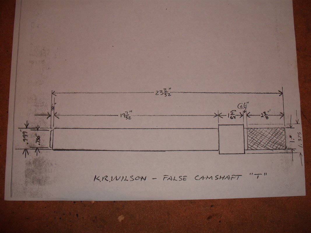

Brent, I found my "somewhere" pretty quick
My scanner is not working so I just took come pics of the diagram. If you can not read all the measurements or need more info, let me know .. These measurements are of a KR Wilson false cam to use with a KR Wilson boring frame. ... other boring frames may use something different

Thanks Donnie. Mine is exactly like the one in the eBay auction pictures, and while I have not mic-ed mine, it looks very similar to the one you posted. It just looked like a 'homeshop-built' unit -and not like what I would have pictured the factory unit to look like. I appreciate your efforts in researching this for me. Thanks again!!dobro1956 wrote: ↑Wed Jan 16, 2019 9:11 pmBrent, I found my "somewhere" pretty quickMy scanner is not working so I just took come pics of the diagram. If you can not read all the measurements or need more info, let me know .. These measurements are of a KR Wilson false cam to use with a KR Wilson boring frame. ... other boring frames may use something different

Brent, yes they are a simple lathe turned item. The only two critical measurements are the .999 shaft diameter, and the 1.375 diameter of the collar. The .999 is the size of the hole in the rear of the block for the camshaft brass bushing, and the 1.375 is the size of the hole in the block for the front camshaft bearing shell. Those measurements allow for a snug "sliding" fit in the holes. The KR Wilson boring frame is designed with "fingers/tabs" to slide against the .999 measurement and then bolt down to the block pan gasket surface.
