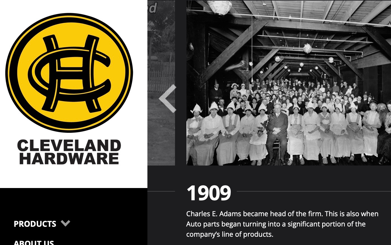

While Daisy is a March1914 build, the left hub is a 1910-13 variant. Also, cast with a "GHC" Logo... CH? I tried doing a search but came up empty....anyone confirm? Possibly a Cleveland Hardware??

That early hub with wide threads can be suspect to cracking so inspect carefully.
Yes the forging mark is Cleveland Hardware
Company still in business, other info from post by T. Boggess.

From the photo of the earlier hub with the long thread, the outer end looks to be somewhat wallowed outwards, so Dan's advice to check thoroughly is sound advice. The Cleveland Hardware logo appeared on a number of forgings on my 1915 Canadian tourer, especially on front axle assembly components. However, I do not believe the hubs were forgings. They are more likely castings. Rear hubs with cracked flanges certainly show this.
