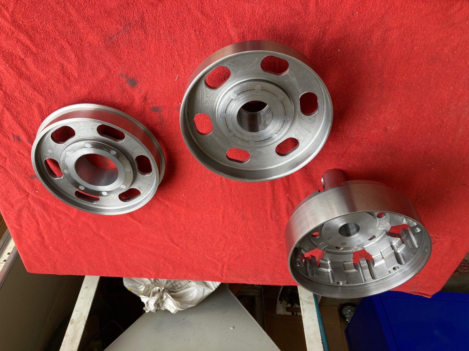

Just received my new drums from Dave Nolting. They are pretty sweet.
Andy

In the process of putting together a complete transmission from Dave. All new parts from the Scat crank flange, to the u joint. Changing to needle bearings nine gears and new pins. This is the second set of drums from Dave in another car and the quality is superior. I highly recommend his drums and also the main trans shaft he produces. Good price as well!
