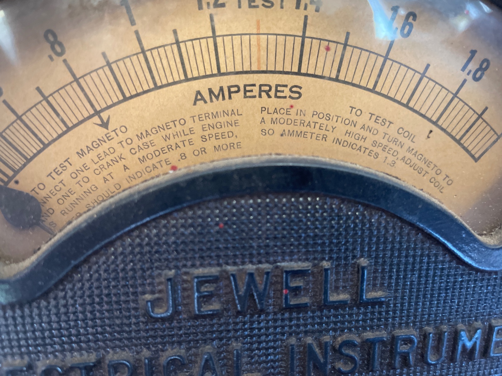

The meter I have tests the magneto AND allows the coils to be adjusted but the caveat is that you need an extra coil so the car runs while you adjust the coil. I don’t know if I will be able to detect the number of pulses.Moxie26 wrote: ↑Sat Jun 01, 2024 2:43 pmAs far as coil point quality, I believe the ones available today are made by one manufacturer and are sold by several of our vendors. As I stated before, I am very satisfied with the quality , and the electrical values that are set during testing do hold up very well. Today, there are several methods to adjust coil firing, I see that you do have a period Model T ammeter in your picture, is it by itself or is it part of a hand cranked coil tester ( HCCT ). Is there a possibility of a member in one of your local chapters in California that can calibrate your coils?.... .. With a hand crank coil tester, the electrical value would be an average of 1.3 ohms and a single spark at each of the 16 pulses in one revolution of the tester handle.

I see. You need an external power source(magneto) from your running T.
You need a better tester.
You basically have a buzz box set up with no power source.
Take your coils to a local member with an ECCT unit.
