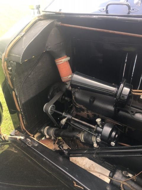

The Model T radiator is not air tight. It is not pressurized like a modern radiator. In the picture below you can see a tube coming out of bottom of the upper tank. It sticks up inside that tank to a height just below the filler cap. If things get hot and bubbly in there any pressure that builds or water that rises above that tube simply is redirected downward to the bottom of the radiator and out onto the ground. Better to have it exiting below the car than up higher where it sprays on the windshield, driver, passenger, etc. In your case, a hole on the cap would allow this to spew out upward and not exit the radiator as designed. Definitely seal the hole. It won't really hurt anything, but it will make a mess of your car.
Note that not all T radiators do not have the same exact tube routing. Mine goes nearly straight down, while the one shown bends to the left and goes down the side of the radiator. You can blow some air up through yours and see if it is clogged as Mark indicated.
