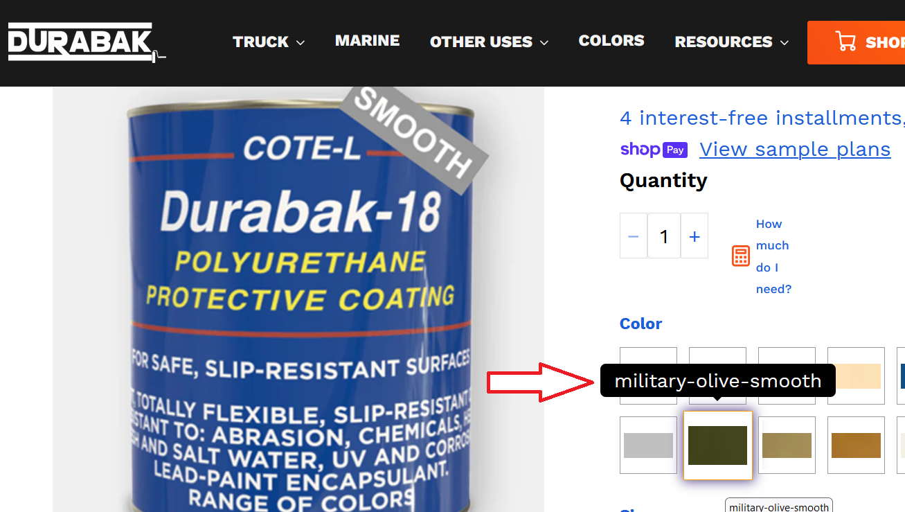

It makes sense to protect one's vehicle. When restoring a T many things are done to make it "correct" none of which Ford did. (paint for one thing). Since you will be paining the underside of your pitted WWI ambulance front fenders lusterless OD green who's to know whats under the paint, pits or bed liner. And if its smooth then .....
https://www.durabakcompany.com/products ... 1676475427
