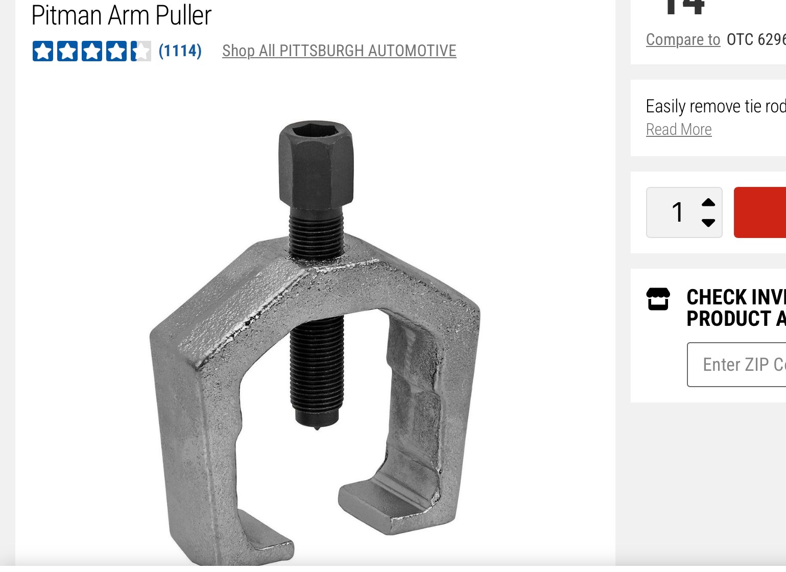

The wire wheel rear hub puller is made from a common pitman arm puller, can be found at auto parts stores under $22, or mine came from Harbor Freight, same china made steel puller for less $
You have to modify by widening the jaw opening to fit the hub, easy with a bench grinder.

They come in 2 sizes. You want the bigger one. They work so much better than the wood wheel puller. I pull my wheels every year and regrease the bearings. I think pulling every year also helps prevent rust inside the hubs so they come off easily every year.

Thanks Dave, are these sold at Harbor Freight?

Tim
There are many choices for tie rod/pitman arm pullers, but the one I used was the least expensive Harbor Freight'Pittsburgh' version, this style is sold by other sources too. Just be sure you can make it narrow to about 1 3/4" gap between the arms to slip around the Ford wire wheel rear hub round section. Had to do a bit of grind and check to get the fit desired.
