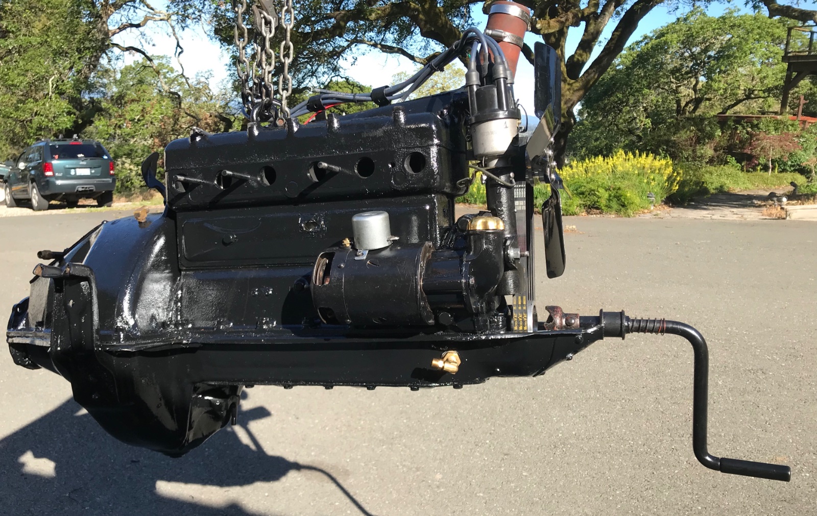

Post by AdminJeff » Mon Jul 15, 2024 1:14 am
I painted my entire engine with POR15 gloss black. It's tough as nails. Still looks great 7 years later. Just be careful not to get it on stuff you care about, it has incredible adhesion. And clean everything really well. I usef 2 cans of carb cleaner on the motor after I got it clean. Nothing like carb cleaner to eliminate oil (and everything else) from anything and everything. Just don't get it in your generator.
