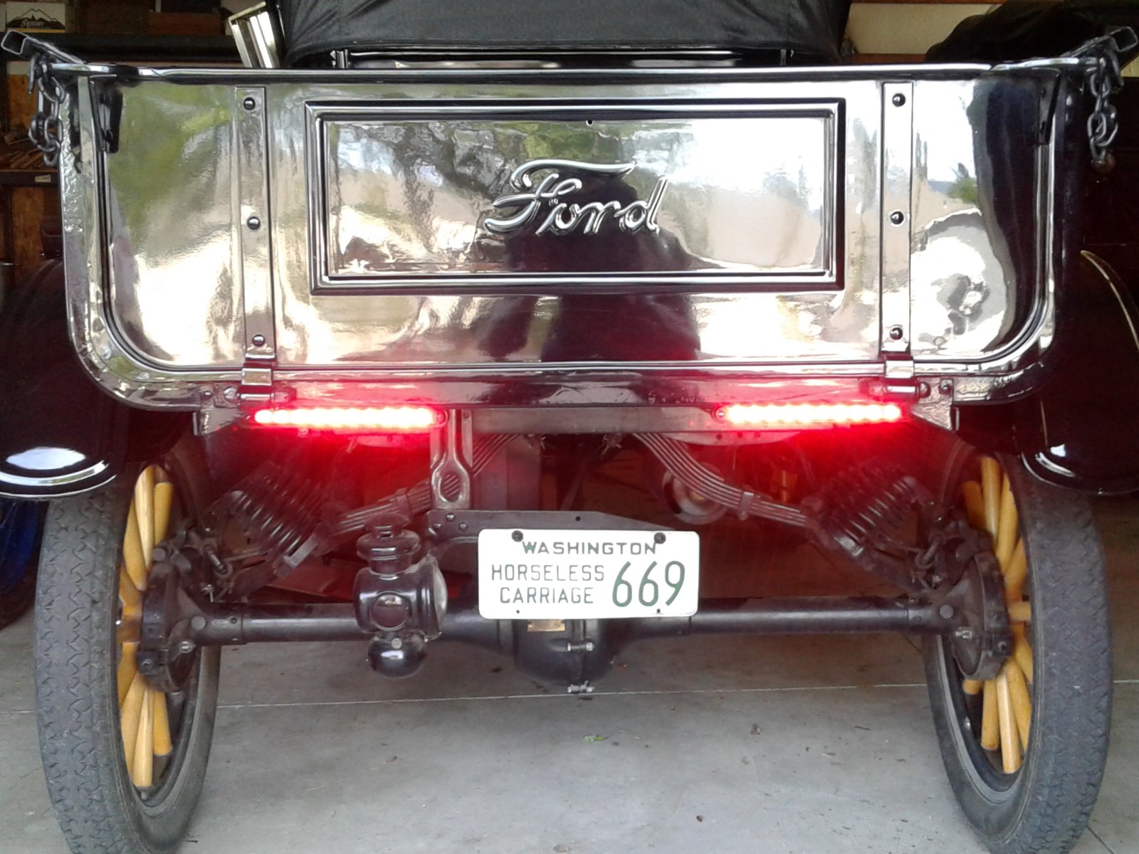

I have this type on a 25 roadster pickup and a 14 run about.  The one's on the pickup are 9 inches long and mounted about 2 inches back from the end of the bed.  Very discrete when not light but really get your attention when you apply the  brakes.  Found them at a led vendor at a swap meet.  They are also wired for signals and tail lights on the pickup.[image][/image]

Jelen, I love those lights and when they're not on they don't look like something that got stuck on and don't belong on a T.
I put some bike lights about the same place on my Torpedo for additional tail lights. During the day you can't see them but they work well at night. Great Job!!
