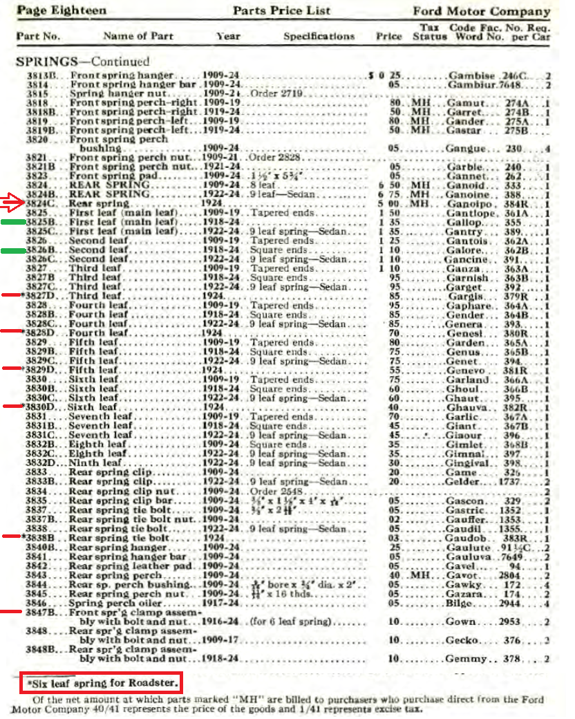

The 23-25 runabouts used a special 6 leaf rear spring. My 23 has the wrong spring in it and I'd like to put the proper one back in the car. Preferably, I'd like to find an original spring for the car, but considering most originals have a significant amount of wear on them and shipping would cost a fortune, I may be better off having a new set made at a local spring shop. Does anybody here know the dimensions, lengths and heights, of the leaves in the special 6 leaf spring?

This may help
From https://www.mtfca.com/discus/messages/1 ... 1302150014
" Dave Martin on Wednesday, April 06, 2011 - 10:56 pm:
It�s interesting to note that the bottom two leafs are the same as the typical 8 leaf, and only the top 4 leafs are different, and have unique part numbers. The book also lists the tie bolt, but I don�t see different spring clips. There was recently a Roadster on the MTFCA classified ads that had this 6 leaf spring, the seller emailed photos, and the unique spring was clearly visible by the shorter leaf lengths.
I understand the parts book lists this unique spring as standard equipment for 22-25, but this particular car was the first one I have ever seen with this spring. Could there be evidence that maybe not all roadsters from the 22-25 years had this spring? With these being the highest production years, it seems like a lot more examples would be around. Unless they were too weak or failed prematurely?
I spoke with one of the gentleman making the �T� springs at Hershey a few years back, and he seemed receptive to making a 6 leaf, if drawings were supplied. I�d like to compare the drawings of the 6 and 8 leaf springs to see if the arch or shape is different, or if the difference lies solely in the length of the top 4 leafs.
Part 3824c would be the entire spring. Since 3825B & 3825C are the first two leaves they would define the arch height (you already have those). Then 3826D, 3827D, 3829D & 3830D the remaining leaves. Also unique parts for the clamp & bolt
