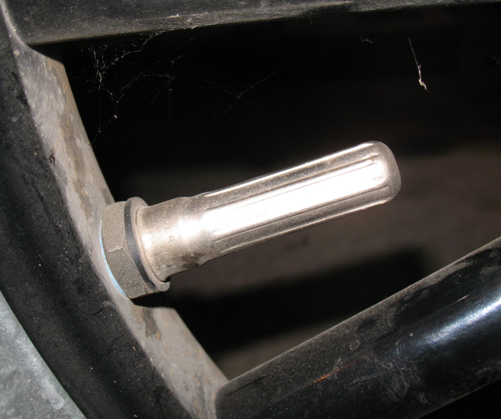

I spent last week on the MTFCI National tour in Cadillac, MI. On our tour to the lake Michigan shoreline community of Manistee I got a flat tire, the first one in over 10,000 miles of driving my 1917 Touring. The tires were Universal T Drivers, which had been on the car for the 10,000 + miles. I posted a photo and narrative on a local Michigan Model T FB site thinking those who knew me would get a chuckle out of my situation. It went viral, and at last count had over 345,000 views, mostly from outside the Model T community. Needless to say, I was surprised by the interest.
What you might find interesting is what happened at the tire shop. I'm fortunate that my local tire shop actually enjoys working on Model T tires and does a good job. They removed a small nail and patched the tube. They wanted to know where I got the tube (I use Blockleys), and they said they had never seen a better tube - both because of the quality of the rubber and the fact that the rubber is thicker than most tubes. When choosing to install Blockleys, I weighed a Hartford and Blockley and found the Blockley weighed 1.4 pounds more. I decided such information was worth sharing.

Regardless of the route you go, my experience is that rubber stemmed tubes are a poor choice with clincher tires. I tried rubber stemmed tubes first and had two flat tires in my garage. In each case, I found that the stem had been cut on the side, by the bead of the tire (photo 1). I learned that "back in the day" it was common to grind out part of the bead to prevent such rubbing (photo 2). Since going with brass stems - no problems whatsoever.

I keep my tires inflated between 60 & 65 psi --- I pump them up to 65 but over time I've seen them lose a couple of psi. I check them several times a season. I understand your comments about not needing a notch but i could find no other explanation for cuts on the sides of the stem. There was no evidence that the tire had ever moved on the rim which would have damaged the back of the stem.
Whatever the reason, I'm a 100% brass-stem guy now!

Some folks are sticklers for originality and will use only #777 stems. Because so many dust covers, including repops, are larger I go with #724 or #725.
Most (all?) reproduction covers fit the #724 and #725 stems used on today's metal stem tubes.
Original #724-#725 dust cover.
