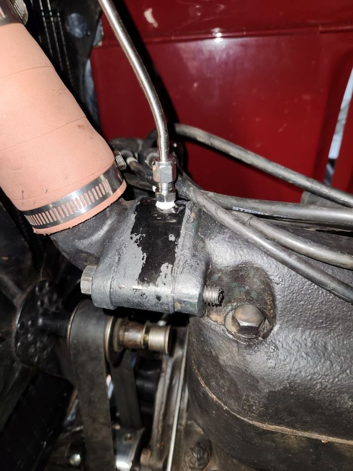

Greetings all,
I find myself looking for your advice once again.
My 22 T has fundamentally a fully rebuilt engine (new aluminum pistons, rings, and plastigauge rod and main journals) with a rebuilt carb, and a new BOSCH distributor, etc. She starts up quickly and runs smoothly but after about 20 minutes of driving I get a slight knock from the engine and it begins to loose power. In more than one occurrence its even stalled and is slow to crank for a few minute. I put a digital thermometer with a thermocouple inside the top radiator hose and the temperature stays around 195-200f - unless I'm going up a steep hill (in low) or at a high speed and she climbs to 210 - where I throttle back. I don't have any sort of tachometer to judge speed -
My carburetor bushings are not the greatest, and I suspect the mixture may go lean when warm due to bypass air.
For overheating my next steps are to 1) flush all, 2) put in a 50/50 mixture of glycol and water, and 3) strip the 'hi heat paint' I have on it now and then spray it with 'radiator paint' from Eastwood. If that doesn't improve it -I may switch to an electric fan ... and go from there. (a New radiator is beyond my budget) (note: no thermostat or water pump)
All that said, my biggest worry is the knock.
So, possibly expanding cylinders with lower compression? Expanding pistons with wrist pin knock? rods need to be checked and possibly taken up?
what else?
Thank you all again - I would never have gotten this car going without this forums help.

ElGranadaT
Posts: 109
Joined: Fri Feb 05, 2021 1:34 pm
First Name: MARTIN
Last Name: SHERIDAN
* REQUIRED* Type and Year of Model Ts owned: 1922 Model T Touring
Location: El Granada, California
Re: loss of power when hot
Post by ElGranadaT » Wed Jul 10, 2024 1:53 pm
Thank you all for the good advice.
When the engine was rebuilt it was done by a professional, seasoned, model T expert who I trust 100%. All tolerances and specifications were met.
We did have a bit of a struggle with the number 1 piston but clearances were all measured and met spec.
I now think the 'knock' may be from detonation - (hopefully not pre-ignition) from the extra heat- and my timing being too advanced.
I think the overheating is from poor radiator efficiency at idle speeds and under heavy load.
So - next steps will be to improve heat transfer by the radiator and tune up the carb/ points and plugs to run smoother at a lower advance...
For the radiator- Going from water to a 50/50 antifreeze will raises the boiling point 3'f (from 220 to 223) at sea level - which does improve efficiency somewhat -but I think increasing the airflow with an electric fan will be a better solution, because it reduces the mechanical load on the engine (no pully, belt, fan...) and it increases the airflow over the radiator... this car did overheat on the 4th parade- and it also overheats during my hill climb home...

Today I did pull the plug wires and no. 1 is definitely the source of the knock ... I should have mentioned this before but the knock frequency was in sync with a single piston power stroke ...
about the 'adapter' between the top outlet and head- (see image). I had it machined in China for $43.00 - fits great and I put a 3mm Type K thermocouple in it - and connected it to a small digital temp readout. So, no thermostat -
I will definitely look into a high volume HH mounted oiler ... every bit helps -
About pulling no. 1 main ??? I am confused on that one - from photos and the T Manual it looks like you need to split the bottom crank case from the main engine block? If I can get to no 1 main - GREAT! what did you mean though about "notch the pan a little bit to remove the 2 main bolts"... ???
