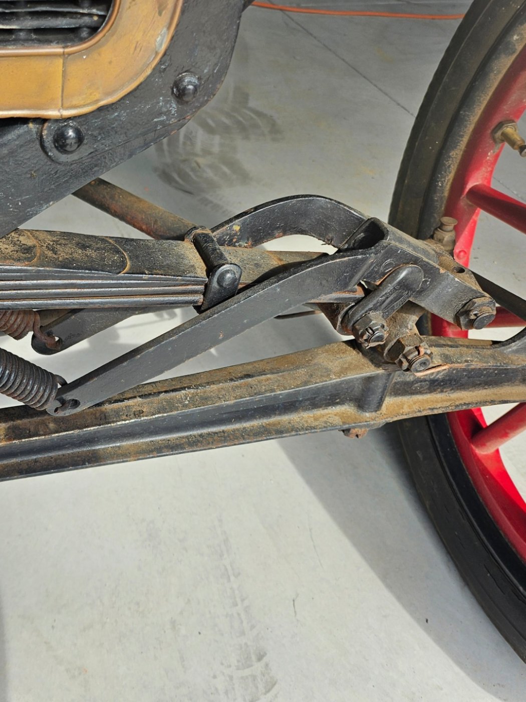

Question 2:
Daisy has after market spring shocks.
I know of the arguments against these. But yet:
1) they are part of the cars very backstory, being installed for the purpose of her cross country trek, and,
2) they are unique in the sense that they are of unknown manufacturer, while similar in appearance to others, they are different enough where have found no other reference, picture, ad.
They are in pretty decent shape, but, still present some minor issues.
The spring perch bolt itself is not significantly worn one side to the other, but the arm itself is slightly ovaled out. The spring perch was drilled out to enable oiling. That would have to remain if I kept the shocks on the car, but I would fill if I removed them.
The shackle mount has a bushing that is locked in between two riveted plates. There is no provision for oiling other than via correct shackles oiled internally (where I am replacing the current shackles for period correct). The sleeve bearing itself is worn enough to where the load is carried across the plates on the ends of the shackles.
Question being.... even with the (seemingly minor) wear in the shocks mounts, given that this will only be an occasional driver, not a long distance tour runner, and given it's place in the history of the car, and uniqueness of unknown origin,....
Would you reinstall, or remove and just keep for display?

- Posts: 5139
Re: Daisy Mae Archeology: front suspension
My 14 came with quite a few accessories. I believe she has the same shocks as you show. I left them on. I see no harm if everything is tight.
In your case, the spring shackles are much later, that & the wear, I would replace them with the correct style figure 8's* & brass oilers.
Daisy Mae
Topic author - Posts: 481
- First Name: Kurt
- Last Name: Andersson
Yes, period correct shackles w/brass oilers will be installed on the rebuild.speedytinc wrote: ↑Fri Aug 09, 2024 4:16 pmMy 14 came with quite a few accessories. I believe she has the same shocks as you show. I left them on. I see no harm if everything is tight.
While these shocks appear to be similar in appearance to others, they are slightly different.
I have only been able to identify 3 manufacturers of dual arm/spring shocks.... W&C, H&D, and Flex-o-plane. All the above have a continuous curve in their arms....but where mine are straight.
- Posts: 7138
I have two sets of this type of shock absorber on my cars. They are English made by Richards Wilcox, and were part of a suite of accessories offered by Duncan and Fraser, Ford distributors for South Australia. Yours I feel are cheaper fabricated steel item rather than maleable castings.
On mine the shackle runs directly in the cast arm, steel on cast iron, but at least they were drilled to accept an oiler. Most are neglected, often too worn to accept a bronze bushing. I was able to piece together a better set for my roadster, and have fitted bronze bushes in them. The other wear point is the outboard end of the yoke assembly pivots. They wear just as yours have. The ones I have have a hexagonal relief in the cast arms in which the pivot bolt head fits, making the pivot bolt fixed in the yoke. They are supposed to move only in the spring perch eye, but like yours, they can move in the arms and flog that point out too.
Despite these frailties, they do work very well, especially on undulating surfaces.
Daisy Mae
- First Name: Kurt
Hey Allen
Yes, mine are the same way, I was remiss in noting that in my post. One side of the shock arm and bolt are slotted to lock the spring perch mount bolt in place on the shock. The rounded out shock arm hole is not born of rotational wear, but simple lateral tension on the system wearing the stamped steel.
The shocks are entirely stamped steel. For the now worthless shackle bushing I imagine I can just drill out and refit a new steel bushing in the assembly.
I'm thinking these must have been a cheap JC Shitney type clone product in the day. But, even so, surprisingly decent shape all things considered.
- Posts: 7138
Kurt, I'd go bigger, with a sleeve welded in, big enough to take a bronze bush.
Daisy Mae
- First Name: Kurt
Even better...thanks for the suggestion!
I've decided to keep the shocks on the car out of respect to their part of her history, given the basis of my goal is to "restore" her in as found condition.
But for the interim the suspension will be returned to stock so I can spend some time restoring/repairing/improving the shock components.
