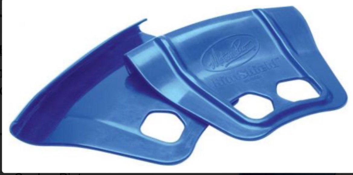

I use these to protect the painted rims while using tire irons. Install the tire and tube as One Unit, starting at the valve stem and working away from the stem. The tube should have enough air in it to prevent tube twist or pinch.
https://www.2040-parts.com/motion-pro-w ... -i1691288/

Post by Aussie16 » Sat Aug 10, 2024 8:02 pm
Rod, I have never seen this product before. Very practical for mounting tyres to protect new paint.
