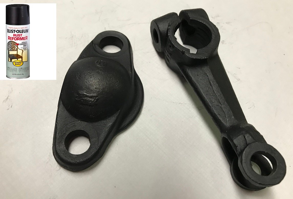

I used this and seems to match the description above. After it dries the surface has a powdery coating that wipes off to a black oxide like finish --
