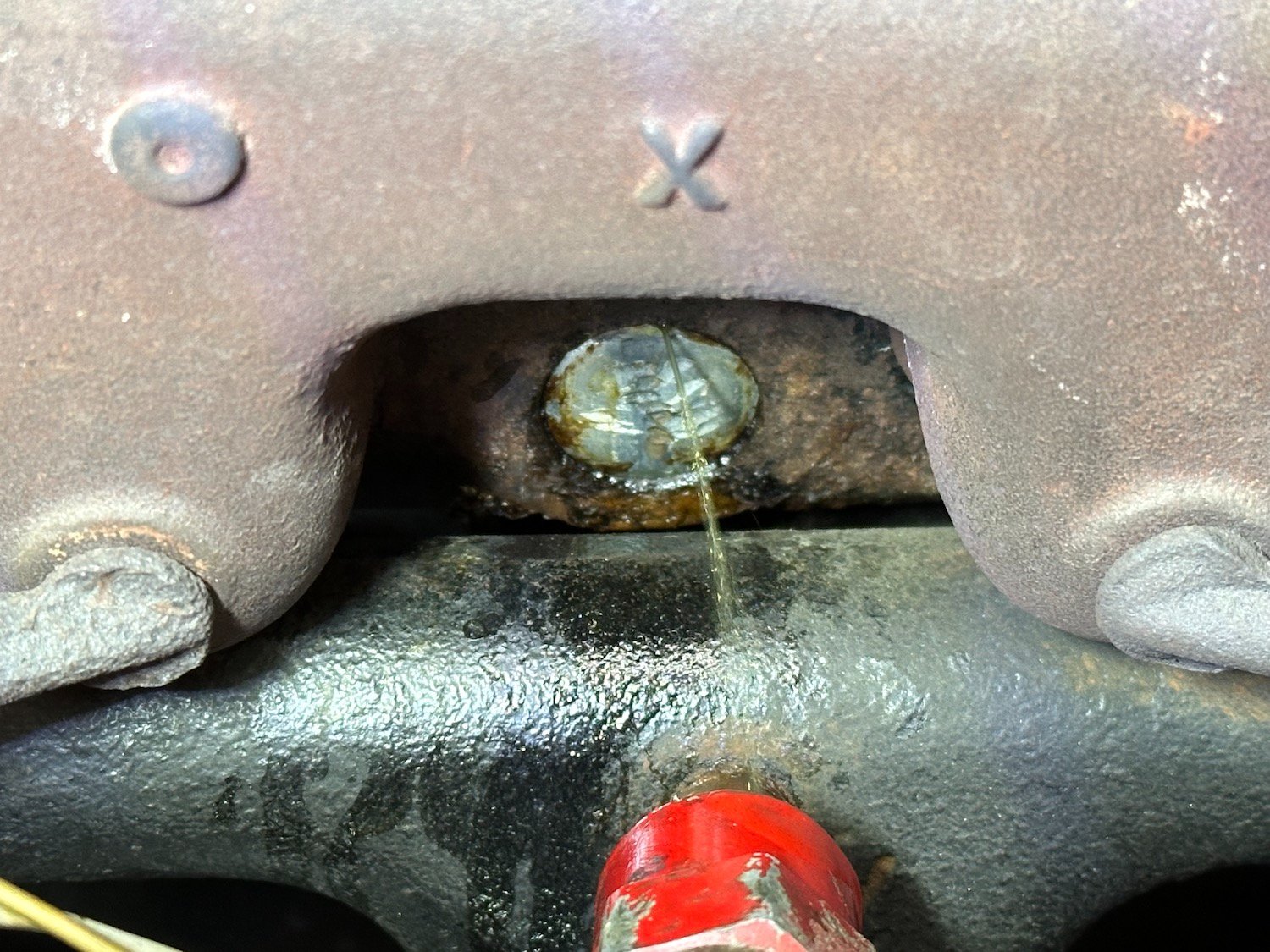

The manifolds came off and new freeze plugs were driven in but that is another story . . .
