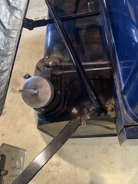

Valid point, yes I should be “good” on fuel quality. It’s a modified period tank (late teens/20s, if anyone knows the year/brand I would love to know) tank that is below the spare. The tanks was cleaned and recon inside. New filter and I have a gauge after filter and regulator to confirm pressure matches my dash gauge too. Running fresh ethanol free 89 octane filled in June maybe. I could double check the pressure on the gauge after the filter to confirm none of the recon coating has flaked off and clogged the filter. Good point!
