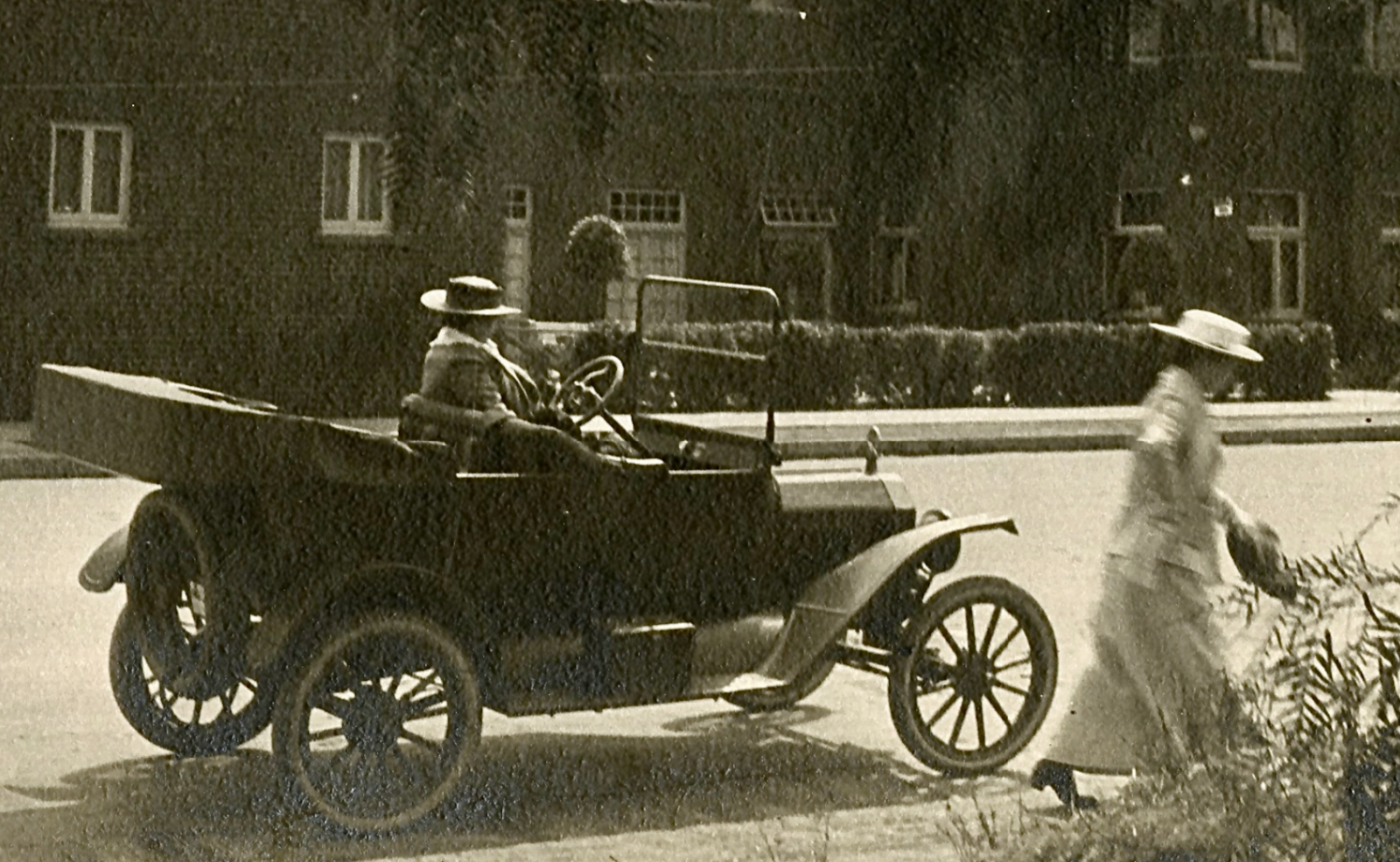

Russ, thanks, that explains it. Took a look around, found a lot of cars so-equipped, including a few with the Stewart instrument panel. From ads, "less speedometer" shows up from August 1915 on, so supply issues plus an August price reduction following the earlier rebate offer?
Wayne, if you get a chance to photograph the mounting holes on your car, would be interesting to see if the dimensions match up.
