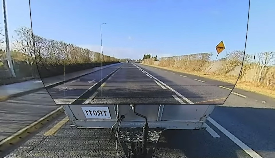

The ultimate camera system makes your trailer transparent. Some of the newer trucks have the option and it’s pretty neat. Sold on Amazon too.
This looks like a good rear view mirror, but how does this help backing up into a parking space? Can't see the end of the trailer.
